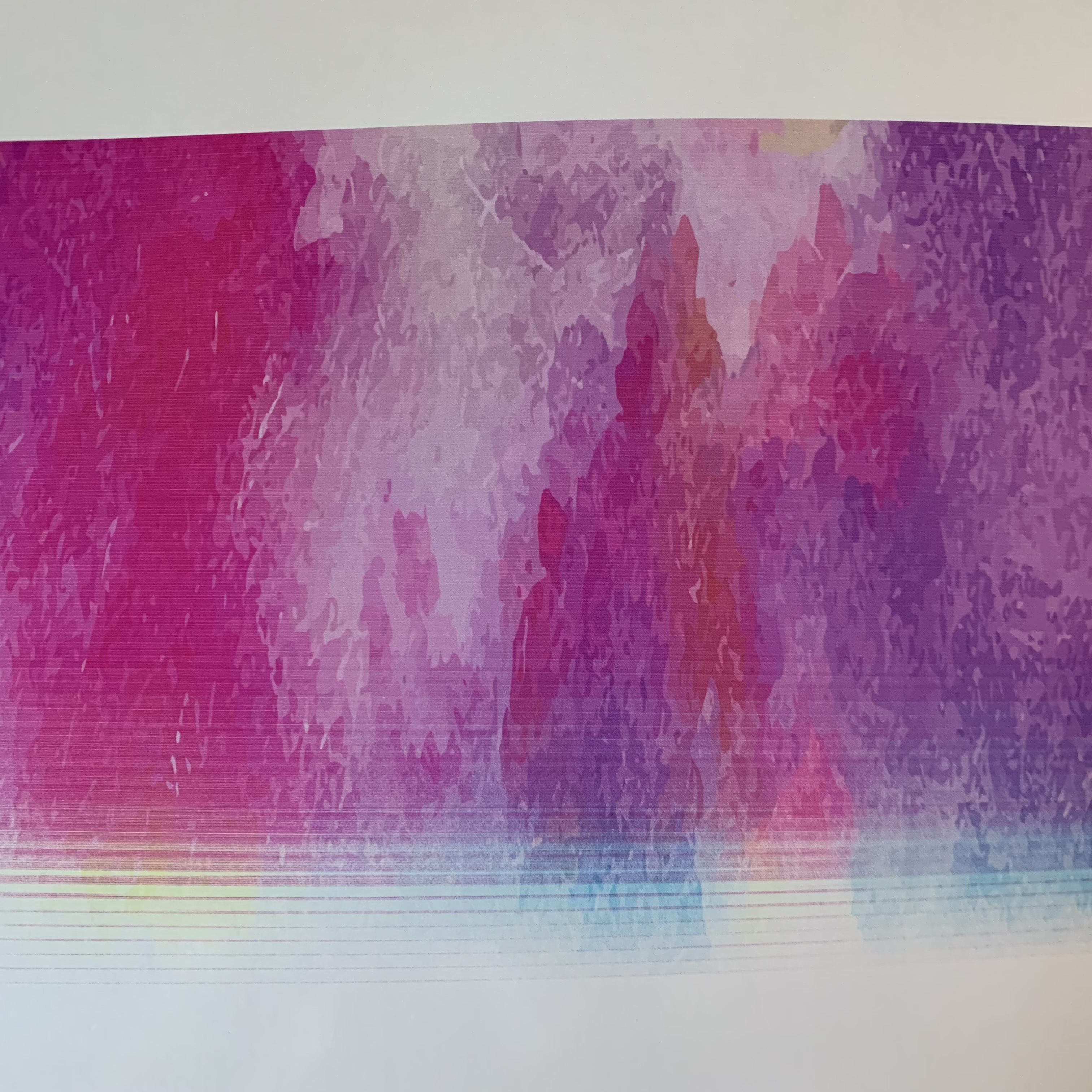

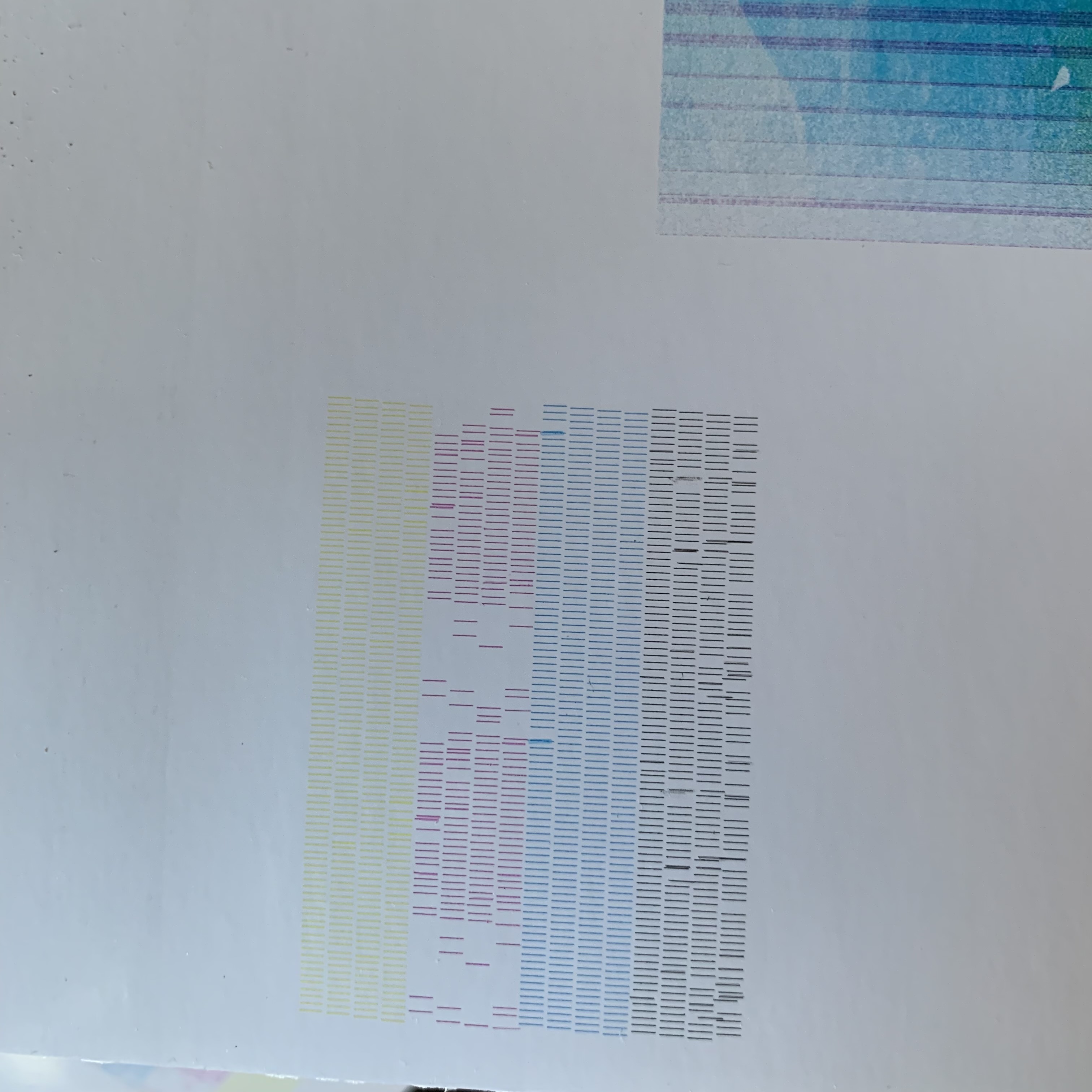

Next I ran this print and it uses a lot of magenta then after about 4 inches the magenta seems to be running out and you see from the sample print something is wrong. I then run a nozzle check and about 1/2 the magenta are not printing. My ink cartridge is almost full, took it out and shook it and reinserted it. I also do several cleanings and nozzles seem to come back but when I try to run the print again the magenta drops out.

As seen in pic should I still be getting some magenta printing with 1/2 nozzles firing on test print but on main print you see it almost stops completely printing?
