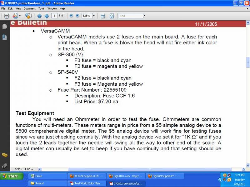

Have you found it?

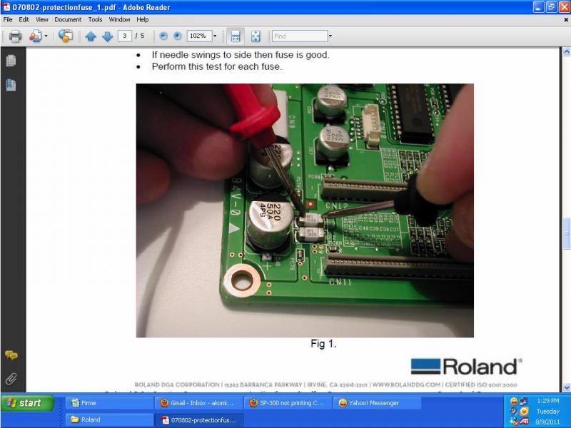

Gabriel
You're welcome! Hope that helps.
Also, check this JPEG!
Regards
allicatgraphics
I just did a continuity check with my meter. F2 was fine. I got nothing with F3. Can anyone confirm F3 is the fuse for Black and Cyan? Also, who would i contact to order them? thanks everyone!

You can see in my 2nd post that F3 is the fuse responsable for that group. You will have to replace that fuse. Check out one of your local dealers.
