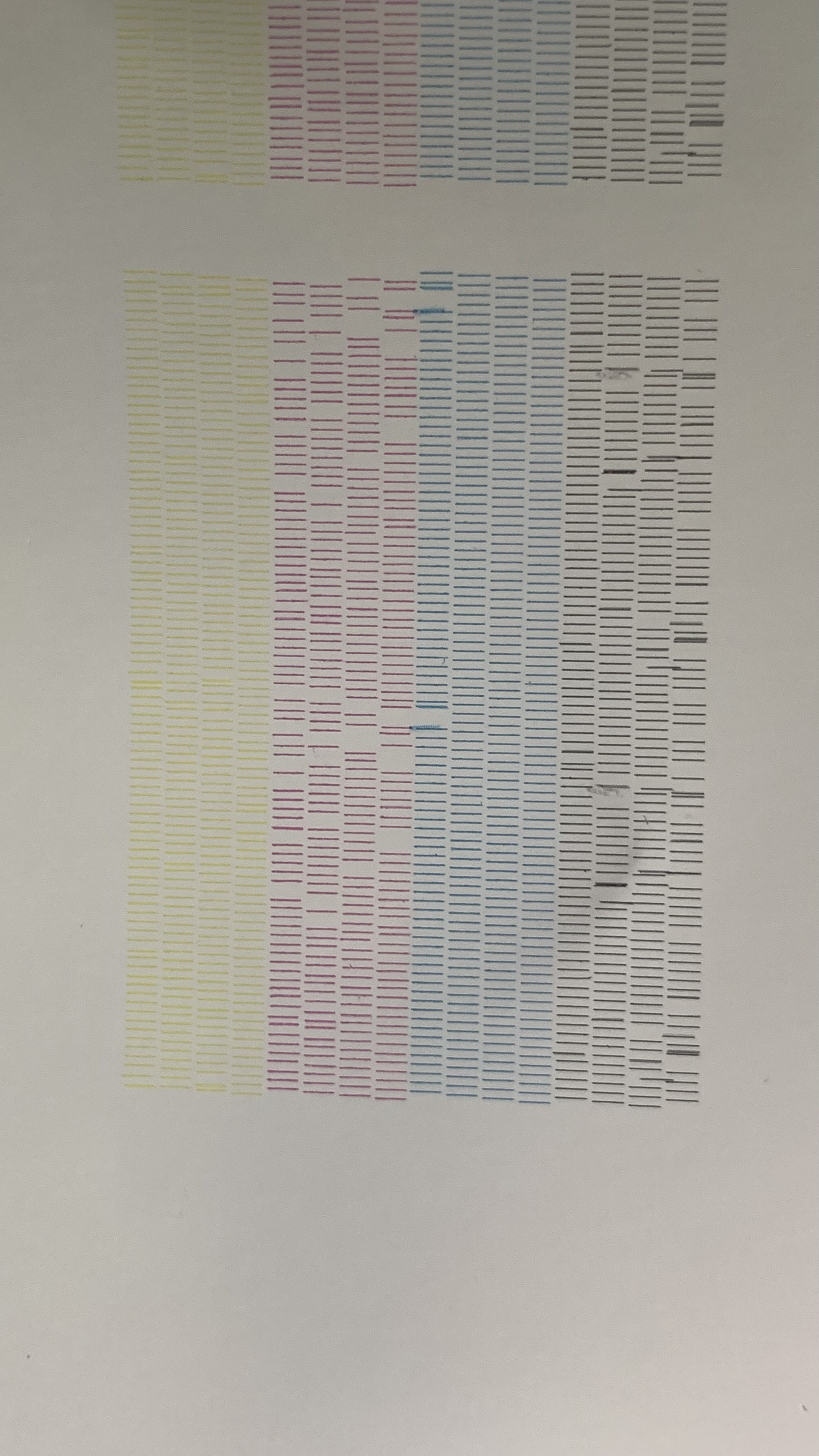

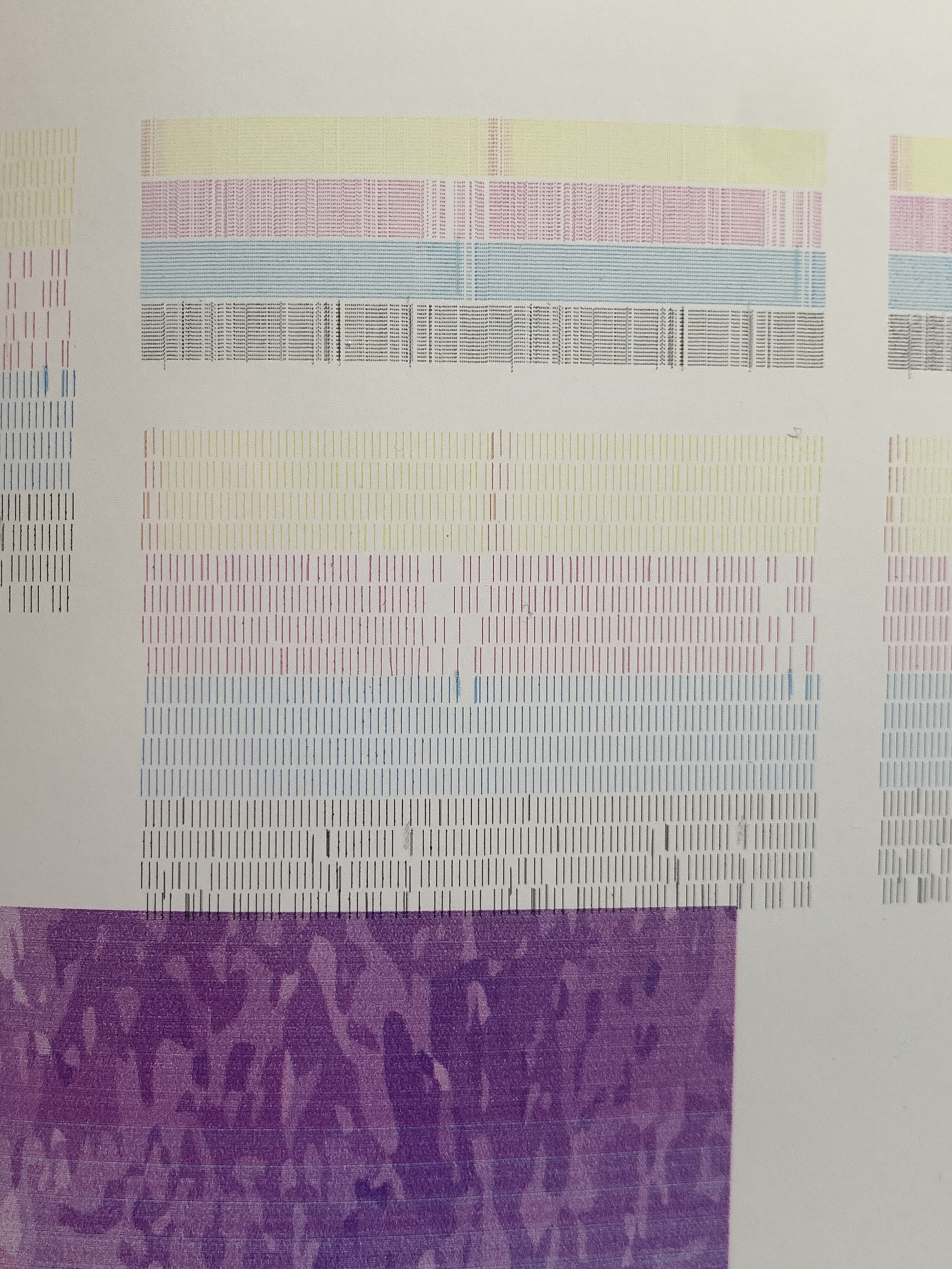

After I put new caps in I did a test print to check nozzles and this strange print came out, two test prints at the same time and one was VERY small as you can see in the pic. I then shut machine down and rebooted and printed again Second Pic, then the small test pattern did not appear. Ever have this happen or know why it did? Maybe I was in service mode?
That's exactly it, you get the small one when in the service menu.

That test print does look quite rough though. If cleaning aren't working to revive, the only other option before getting new heads, would be to attach a syring at the bottom of the cap top line and try to pull ink through, then do a cleaning and see if it brings back any of the nozzles.
