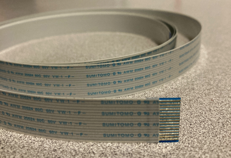

Just want to make sure i ordered/received the correct cable before i call for service. I bought this one from DigiPrint and never had issues with them before, but i expected this cable to be alot wider. The bag says...CABLE CARD, 15P1 1900L BB SP-300 SKU:23475207. The cable is 6 feet long by ⅝ inch wide. Pict is attached. If anyone can verify that this is the correct cable that would be wonderful. Thanks!

Thats the one. If you feel just over the back of the encoder strip, you will feel it laying on the frame.
damonCA21
Yes that is correct. Its not a particularly hard job to fit it yourself, you just need to thread it through where the old cable went. When I do them I normally tape the new cable to the end of the old one and pull it through

That's exactly what I did, and all is working! Thanks everyone...saved $400 and a two week service call wait.
