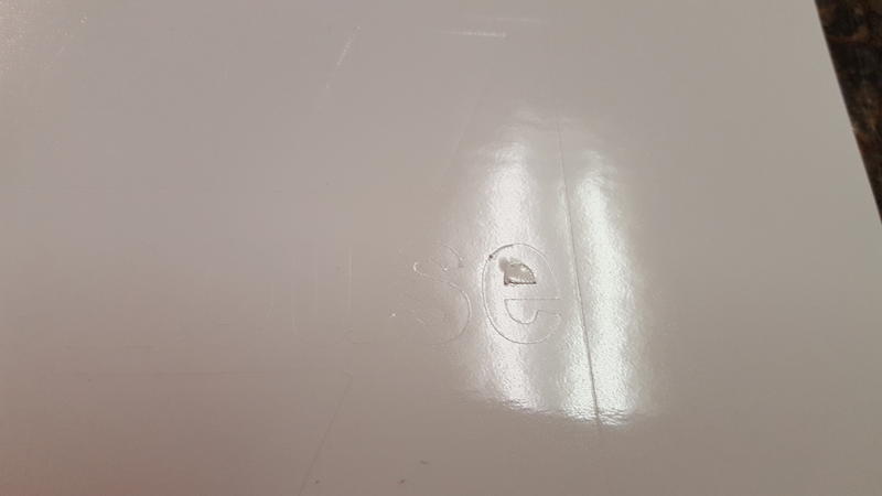

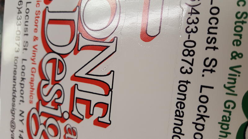

The cut seems to get rigid at random spots, seems to occur more with rounded areas when both die cutting and print/cutting.
45 blade just replaced it have tried numerous other troubleshooting techniques. Can be seen above the N in attached image.

Is this laminate? Is the heater on when cutting? How old is the blade? Is the a lot of space with the blade holder?
If I recall correctly, the roughness is from a dull blade or not enough pressure. Offset can change depending on the angles.
How does your test cut perform and what does it look like when you pull the outer circle out?

Not laminate, heater is on, I just put in a new 60 blade to try out. Not a lot of space with the holder. The test cut comes out well its just randomly will give me those messed up lines.
