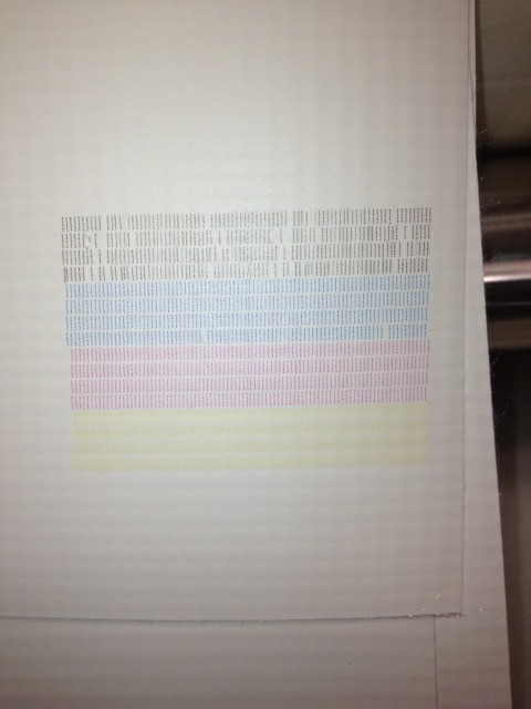

I just printed the test print on banner material but overall looks good. The black is dropping out but yellow and magenta are perfect. A couple blocks are missing in the cyan and a few more in the black. Nothing terrible looking tho. I'll attach the pic after I get it off my phone.
wmshuman
Here are some pics:

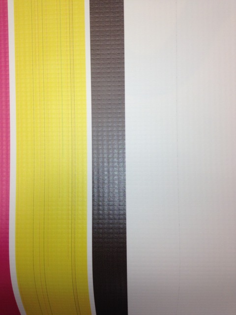

wmshuman
More Pics:
This pics shows the missing black section. If you look close you can see where it printed the very last line of black.

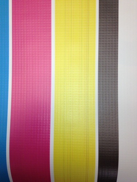

wmshuman
More pics:
This pic shows the 2 inch lines I was printing and the various lines in the yellow box.

CS-SignSupply
Power off the printer and unplug the main power. VERY IMPORTANT!
Then check to make sure the Ribbon cables going to the printheads are securely fastened into the head and the head board... normally the connection to the head board is fine.
If a cable is loose, you can get some odd electrical issues.
Button the machine back up, plug in and power on. Try again.
