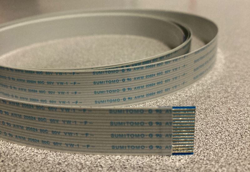

ok, so i replaced the pinch roller sensor...but still getting the same errors...so i bought a cable, but not sure if its the correct one. Its from digiprint and the bag says CABLE CARD, 15P1 1900L BB SP-300 SKU:23475207 its 6 feet long by ⅝ inch wide...i was expecting a wider cable (see pict attached). This looks too complicated for me to try and replace so i guess i gotta call for service, but i wanna make sure this is the correct cable. Thanks!

Hah...did it...replaced the cable, works like a charm now! Thanks everyone for your help, wasn't sure if this was something I could handle without causing more problems, but once i took all the covers off, it didn't look too difficult.
