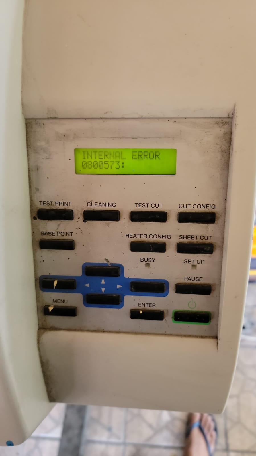

SP 540 internal error 0800573
Keevan
Hello, anyone have any ideas what this is?

It's sort of a general error when something unexpected happens. If it keeps popping up, one of the parameters might be messed up or you might need to do a limit position initialization. I'd try the limit initialization first then if that doesn't fix the issue, I would reset the main board and start from scratch.

Thank you for your response. I don't know how to do any of the things you suggested. Can you assist with some instructions?

For the limit initialization, I would assume it would be similar to the SP-300V, which you can do as follows: remove I/S Cover, then turn on sub power while pressing left, up and right keys. Then follow the instructions on the screen and you should be good.
