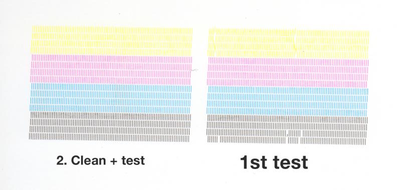

Post a print out of your test print pattern and we'll be able to tell you if its a head issue.
waxworx media
Test Strip
we printed a test, then we initiated a clean, the printed again.

jasonx
Alex.
You don't need new heads.
You need to clean around your heads with cleaning fluid and swabs. Looks like you have a fiber attached to one of your heads which will cause the ink dropping.
The cleaning procedure is in the manual.
