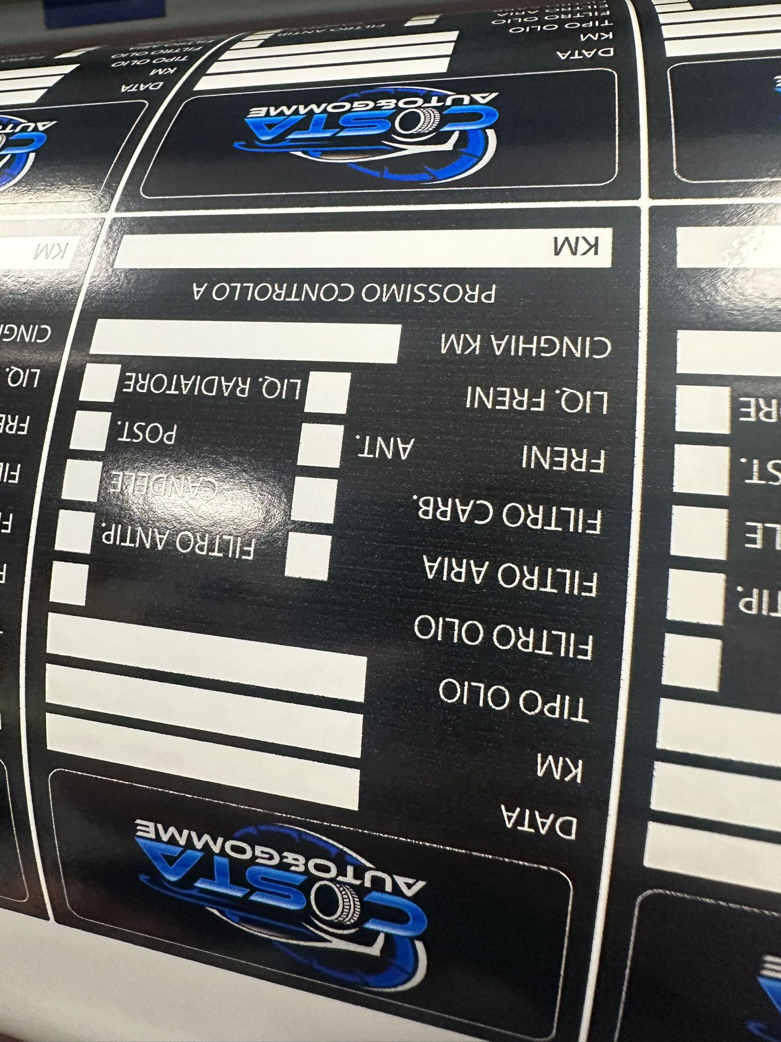

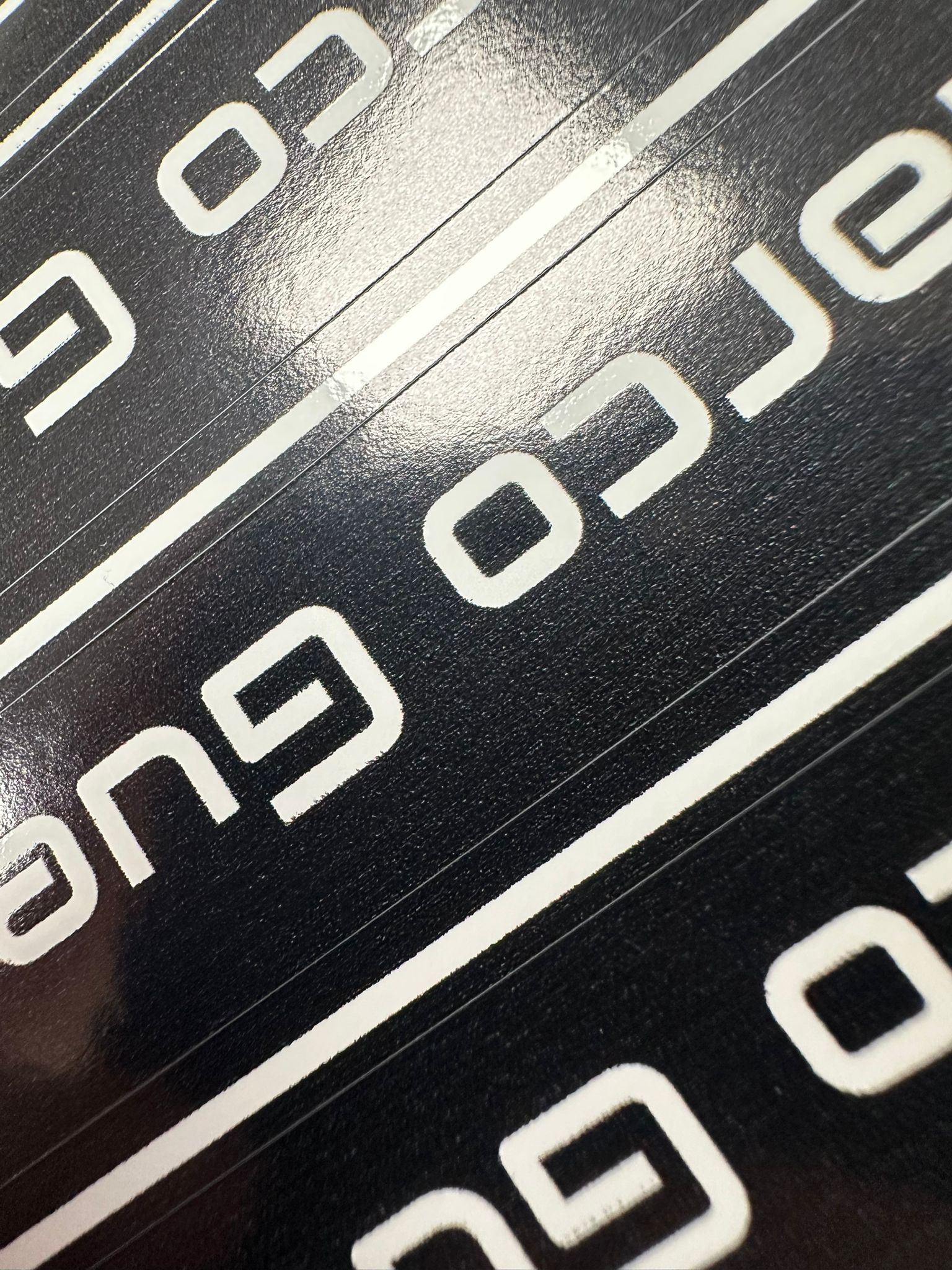

Hi, I have problems with my Roland SP 540i plotter, it prints black with stripes. I attach my test print, the head is new, changed in February of this year. Does anyone know how to fix this problem? Thanks everyone in advance

You do have a couple of slightly deflected nozzles, would need to see the service level micro-dot test.
However, check you feed calibration on the printer and make sure you are making the proper setting in VW by choosing the Use Printer Setting or entering the feed calibration in VW Custom setting.
What quality level is this?, try High Quality if not on that yet.

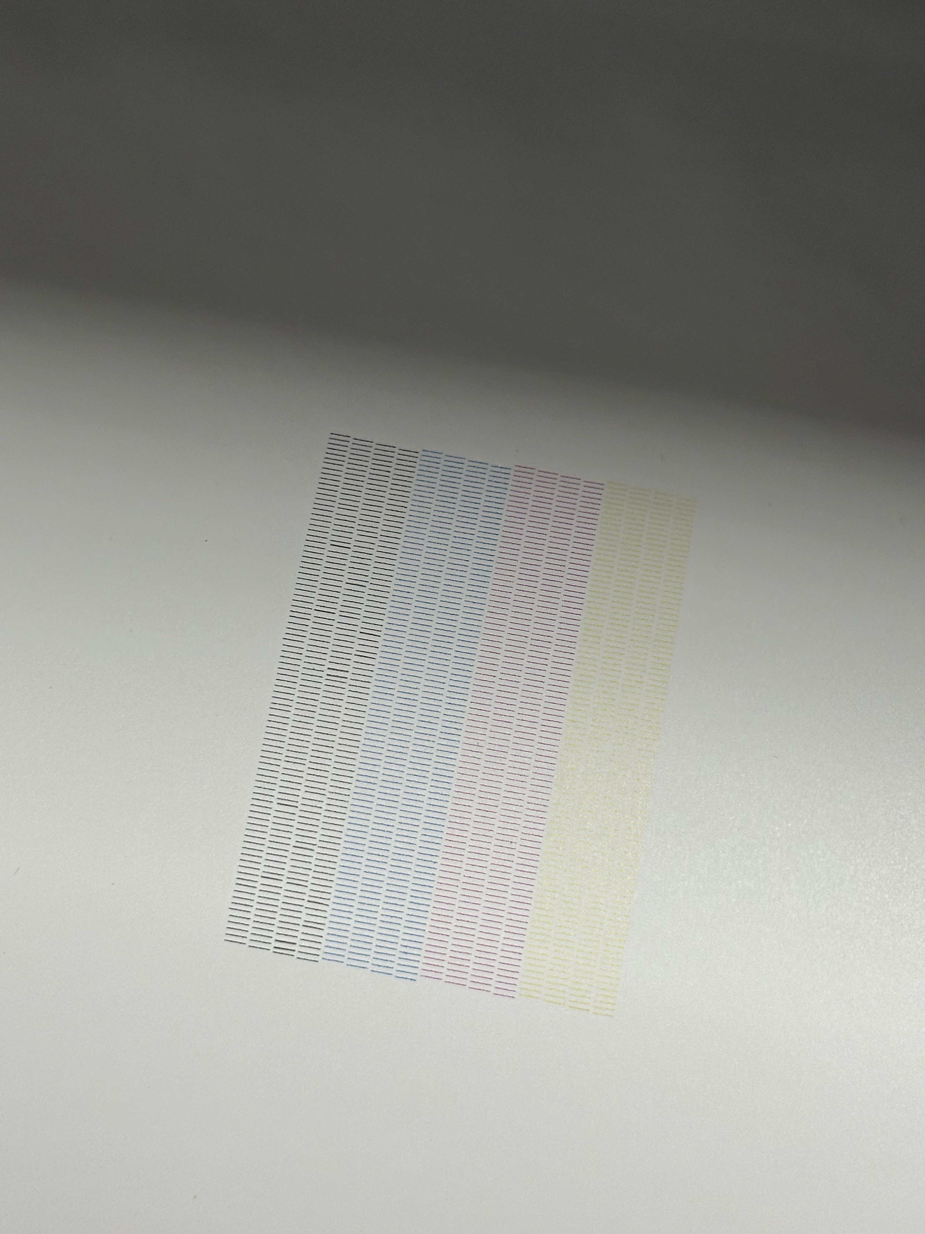

Hi, i've tryted with High Quality and unidirectional printing, but I still have some ugly white streaks. Here is my latest test print.
Is there any way to save the head or be able to print decently?
Thank you! :)

As mentioned by Roland Tech, go into the service menu and print a test strip, it will do a more detailed one with some smaller bars that might give more insight. However, based on your first photos, it could be simply that you need to play around with the profiles. Is this a new media or is it the same stuff you've always printed on?

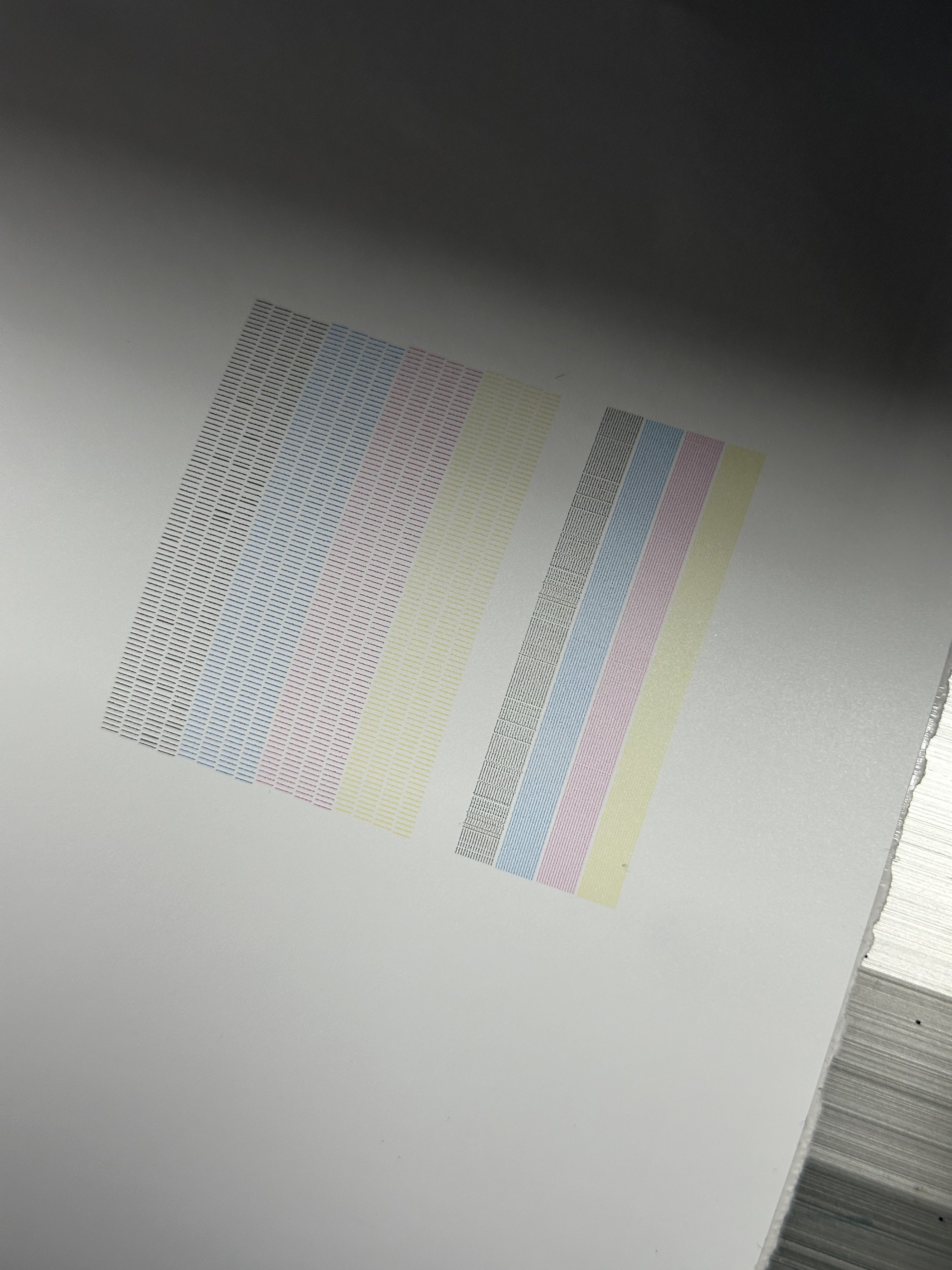

Hi, is this correct?
Yes it is. As you can see, in the black there is a bit more damage showing in the small bars. You might be able to get away with it for the time being playing around with profiles and not using pure black, rather using a combination of the other colors (CMY). However it does appear that you might need to replace the black/cyan head
Yes, now you see your black head is bad, most likely causing the banding.
try different profile and possibly try and “cheat” the feed calibration tighter.
