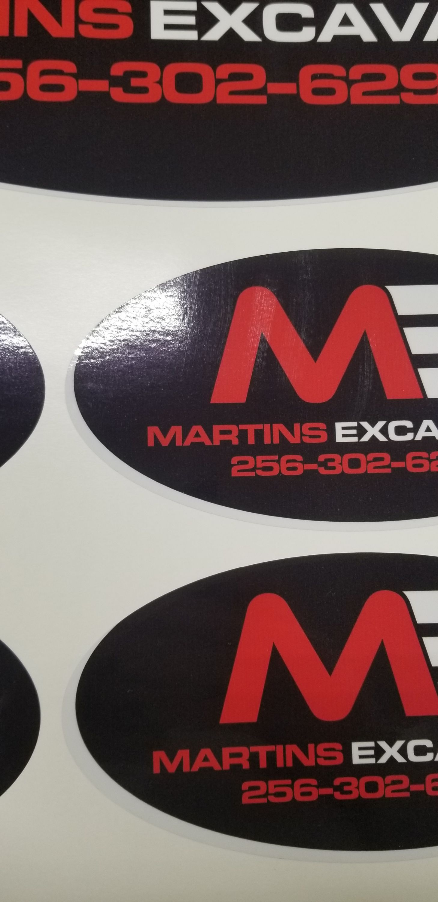

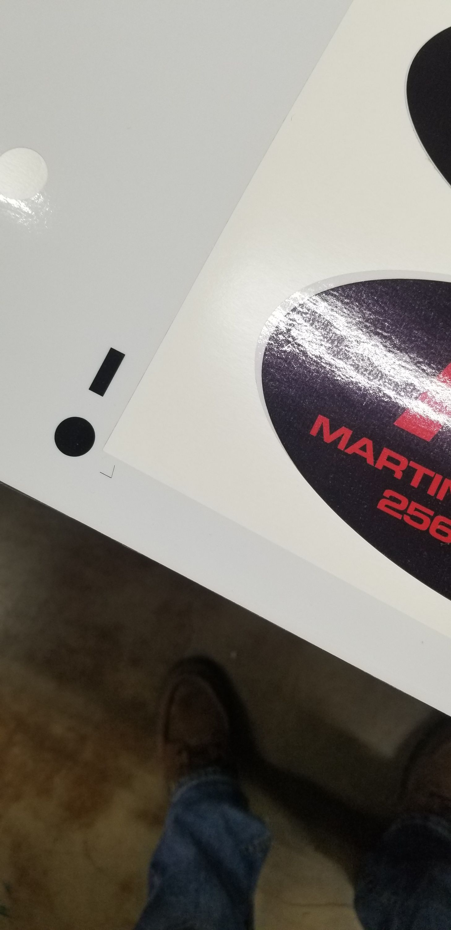

When cutting contour cuts, my media will not track straight on anything over 2 feet long. I have replaced the blade and cutting strip and adjusted force. This is with using all 4 pinch rollers. This has been an ongoing problem which keeps me from producing large decals or large gang sheets of small decals. I'm at a loss.

You will probably have to replace the outer pinch rollers (complete with the black part holding the rollers)
Look closely at the black parts, where the sit on the actuating rod. They tend to get cracks and don't have the correct spring loaded pressure anymore.
southernink
Thank you for the input. While inspecting the roller assemblies, I could see the cracks and the have a lot more up and down play than the inside rollers. This is a problem I have dealt with for 2 years. So you don't know how much I appreciate your advice. You're the first person to ever mention the cracks in the assemblies. Again, THANK YOU!

Make sure the rubber wheel on the pinchrollers did not come loose. I had that issue a dozen time in the last 15 years. Just hold the whole pinch roller and push on the rubber to the side and see if it comes off the metal roller. You can just change the wheel itself. No need to order a whole assembly. Also make sure you order the correct one. The ones on the outside is different the rest. ( they are tapered) DO NOT lose the c clip when you changing them. It's ridiculous but you can only order them in a LARGE quantity ( 50pcs)
SigSignsMT
While this doesn't serve as a solution, consider incorporating a bleed into your artwork. It appears that there's currently no bleed, and you're cutting directly along the edge of the black oval. This should give you some wiggle room.
