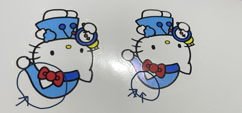

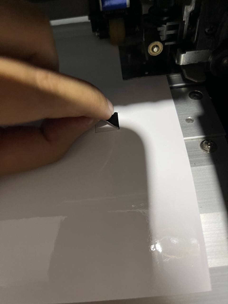

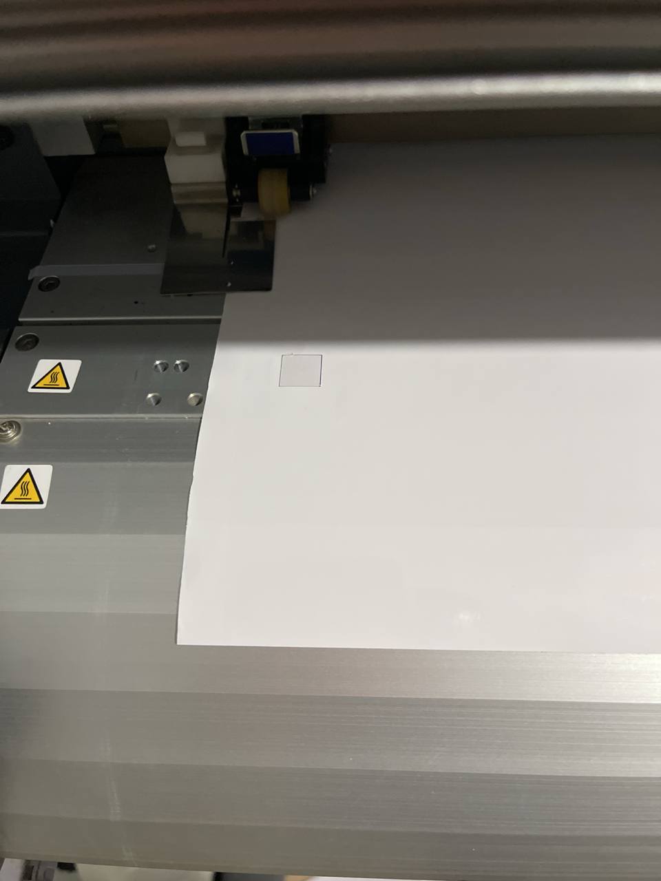

Hello, I have an SP300i model, I have been having a problem for the last 1 week. When cutting the media, when it cuts at the beginning, it does not cut completely as seen in the photo, but the cut gets smoother from the beginning to the middle. What do you think could be the cause?
Our cutting speed is at its latest setting, and it was fine until a week ago. We changed the cutting strip, changed the blade, updated the versaworks app. We cleaned the encoder strip, but if there are 180 stickers, it does not cut off part of the 1st sticker. Afterwards, it cuts 179 stickers without any errors. We did not change a single blade holder. However, we think that if there was a mistake in the knife holder, wouldn't there be a mistake in the other stickers?
Thank you very much in advance for your help.

Yes, I updated the program thinking it was a software problem. It acts as if the knife does not remove the blade when it first reaches the cutting point. I couldn't understand the reason. I think that when placing cut edges in the CorelDraw program, it does not read the first point of the points created.

It didn't get better, I leave 2 round cuts before printing. They also make this mistake and cut the other parts properly.
damonCA21
It doesn't seem to be a software problem them if that isn't fixing it. It is most likely a problem with the cutting head then, sometimes if the solenoid is failing it can miss parts of the cut as the head doesn't lower when it should, but then does for the rest of the cut. Either that or the cut carriage board. There isn't really any way to fix these though, they need to be replaced. You can get used ones on ebay though

I changed the blade holder, the same problem persists. I will install Versaworks from scratch, I think there is a problem with the black mechanism that holds the blade holder.
