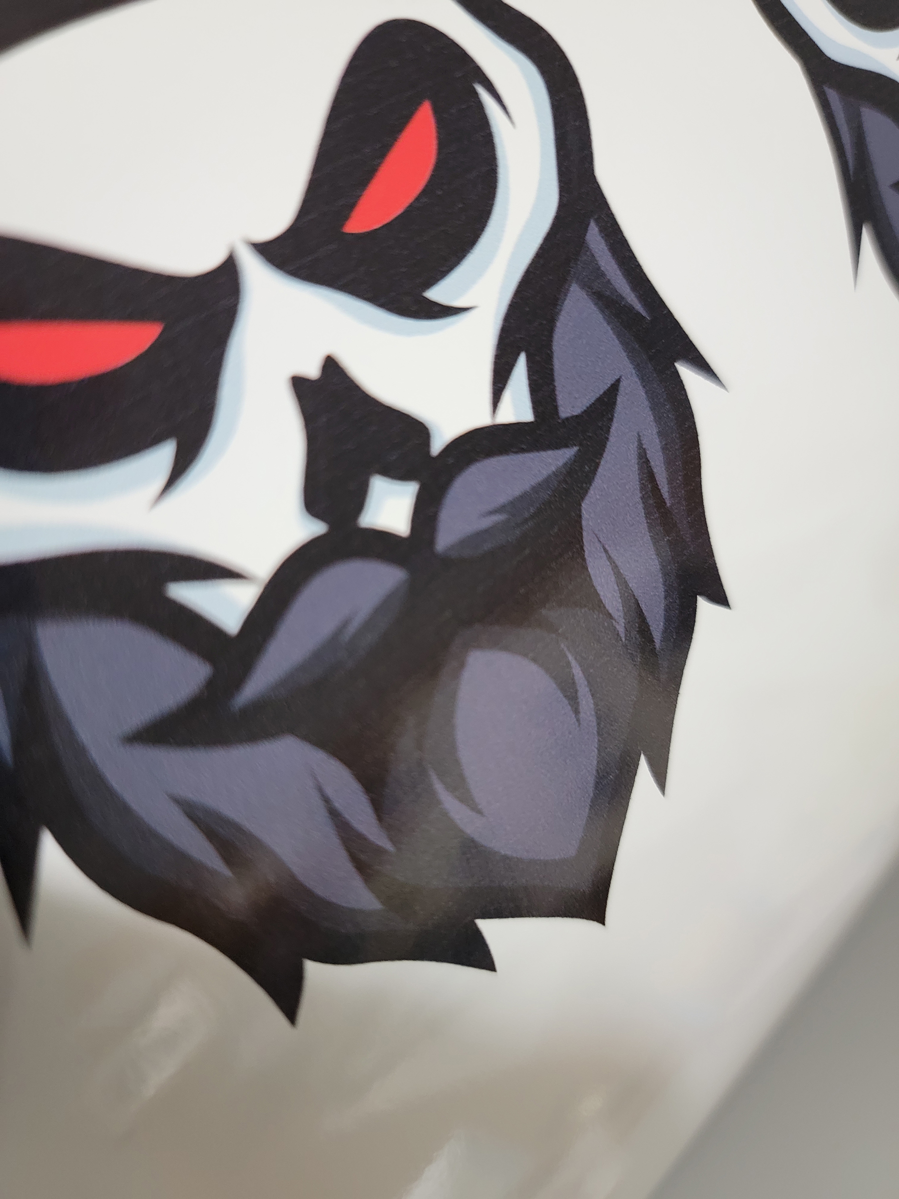

Since a month or two I have problem with my prints. The darker colors are affected, I mean those using black ink. Bright colors don't have those lines (as you can see on the picture below).
The black head has been changed 1 year ago. Last summer, I changed the wipers and the captops. In the same time, I also removed the encoder strip and cleaned it with acetone. I didn't change the dampers and I don't know the last time they have been changed.

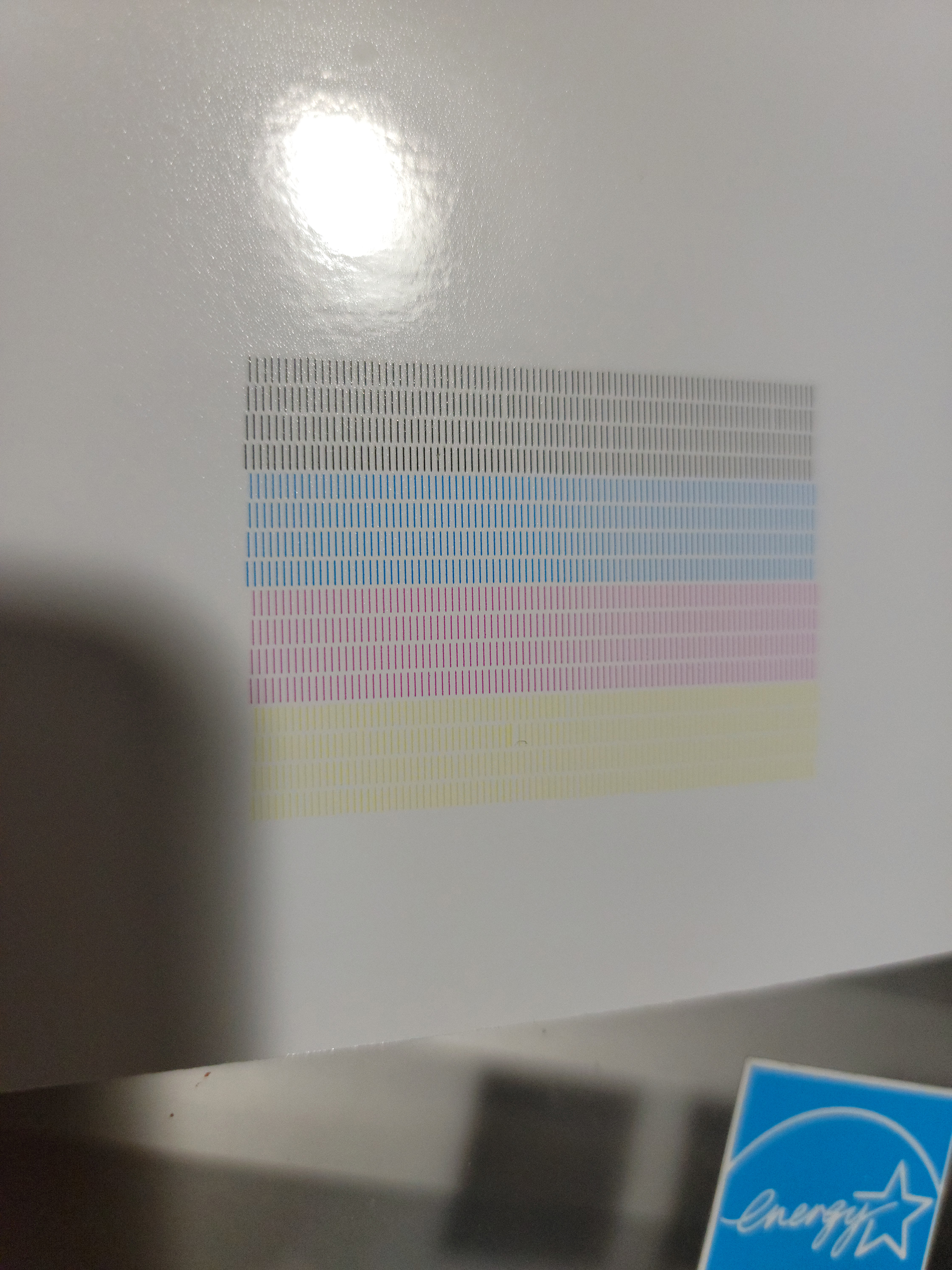

I did a print test and everything is beautiful. I also went into the service menu and printed solid stripes of the 4 ink cartridges. The black was solid, no lines as it appears on the picture below.
This print is on a oracal vinyl. When I was printing on Roland photo paper, that was not happening, but since a few days, those line appears on this paper too.
Should I change the dampers ?
Thank you !

Have you tried playing around with the profile settings? Are you doing a high quality print or just standard? Also you could play around with the speed and heat, but I think it could be partially an alignment thing. Have you done a Calibration recently to make sure the feed gap is correct?
Eric Lemay
Yes I tried many profile such as many papers. This was happening first only on vinyl, but then appeared on photo paper and t-shirt vinyl. I didn't do an alignment yet, that's a good idea to check this out.
