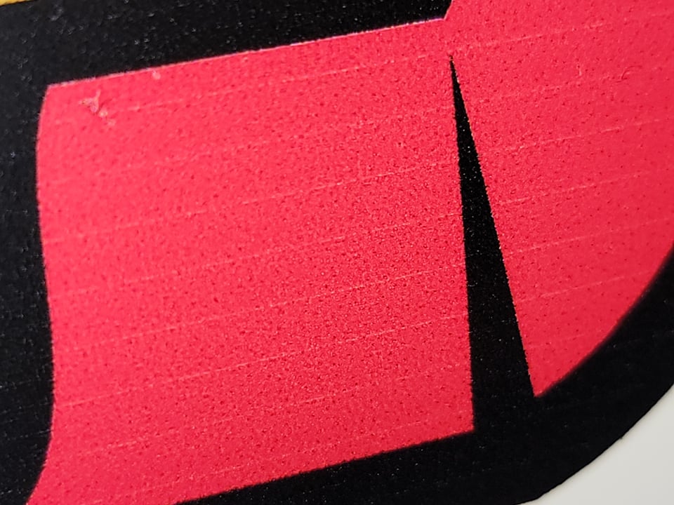

For some time now, I have had a printing problem with my SP300i. As you can see in the image attached to the message, it has white lines.
The first time I noticed this problem was when I printed a mural about 2 months ago. I took care to clean it from top to bottom afterwards and the problem was gone. However, when printing another mural about 1 month ago, she did it again.
I had noticed that she used to do it on big prints over 2 yards and not on small prints. I then believed in a computer problem, of the kind too much data sent. However, now she still does. If I clean it up after one print, I may be lucky and it won't do it for 2-3 more prints, but I have no peace of mind and need to find the source of the problem. Where do you think this problem comes from?
I bought the used SP300i in September 2020. Once I got home, I called a technician. He changed the printhead from black and red, changed the wipers and foams for head cleaning. The only consumable part that had not been changed at this time was the encoder strip.
I have also attached a test print to the message.
Thank you !

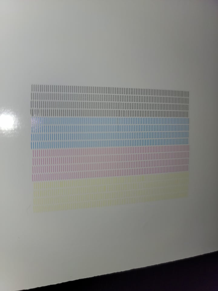

Although it doesn't look like typical drop out, I would start with changing out the dampers especially if they haven't been changed out in the last 12 to 24 months. The nozzle check looks fine other than a few deflecting nozzles in the black but that shouldn't affect the print too much. Also, make sure the head sin't dragging on anything while printing such as a swollen spit sponge, or even just ripples in the vinyl raising up and allowing the head to scrape across.

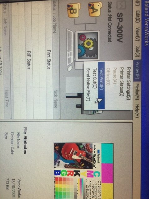

What dpi are you printing and have you performed a printhead alignment? What does a print look like if printed at 720x720 or 720x1400 and what program are you using for your prints?
If you have versaworks, do a quick test print and see if there are any lines..
Eric Lemay
I'll start there since I don't know if they have been changed. Thank you !

Terry01
Do this test to verify your printer is printing the correct colors with no bands...I think you will find it is the vector file that is the problem

Eric Lemay
I did the test last day , the test came out great, but if I look really close I can see minors, minors lines into the black but nothing agressive. I did a full clean before doing the test.
