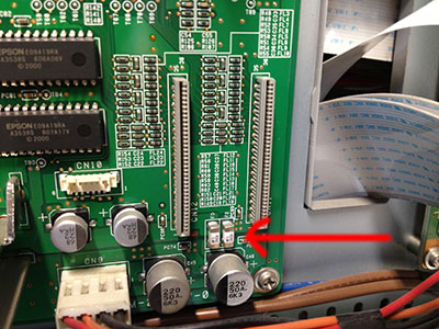

Because the fuses we all mean are responsible for the heads only, a working mainboard led doesn't mean anything in this case.
I have found a picture of the fuses on a SP540V-Mainboard. You can use a voltmeter to check it (lot of them are suitable for checking fuses with a sound function) and solder new ones on the board if needed. I'm 99% shure that this fuses are damaged because 99% of all "I have plugged cables and now the printer don't print anymore"-problems (very often on signs101) are because of killed fuses. In 1% of the cases additional things are damaged because of the same reason.
BE CAREFUL: if doing manipulations on that board, even if just unplug or replug cables, disconnect the printer from the power source before. Be shure that the cables are correctly connected again BEFORE connecting the printer to the power again.

Thanks for the info meant to post back earlier but yes both print head fuses are bad. Wish I could find the local but I will have them Tuesday.
