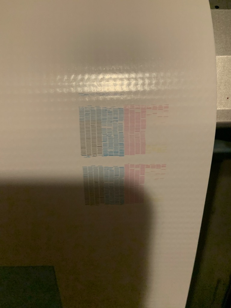

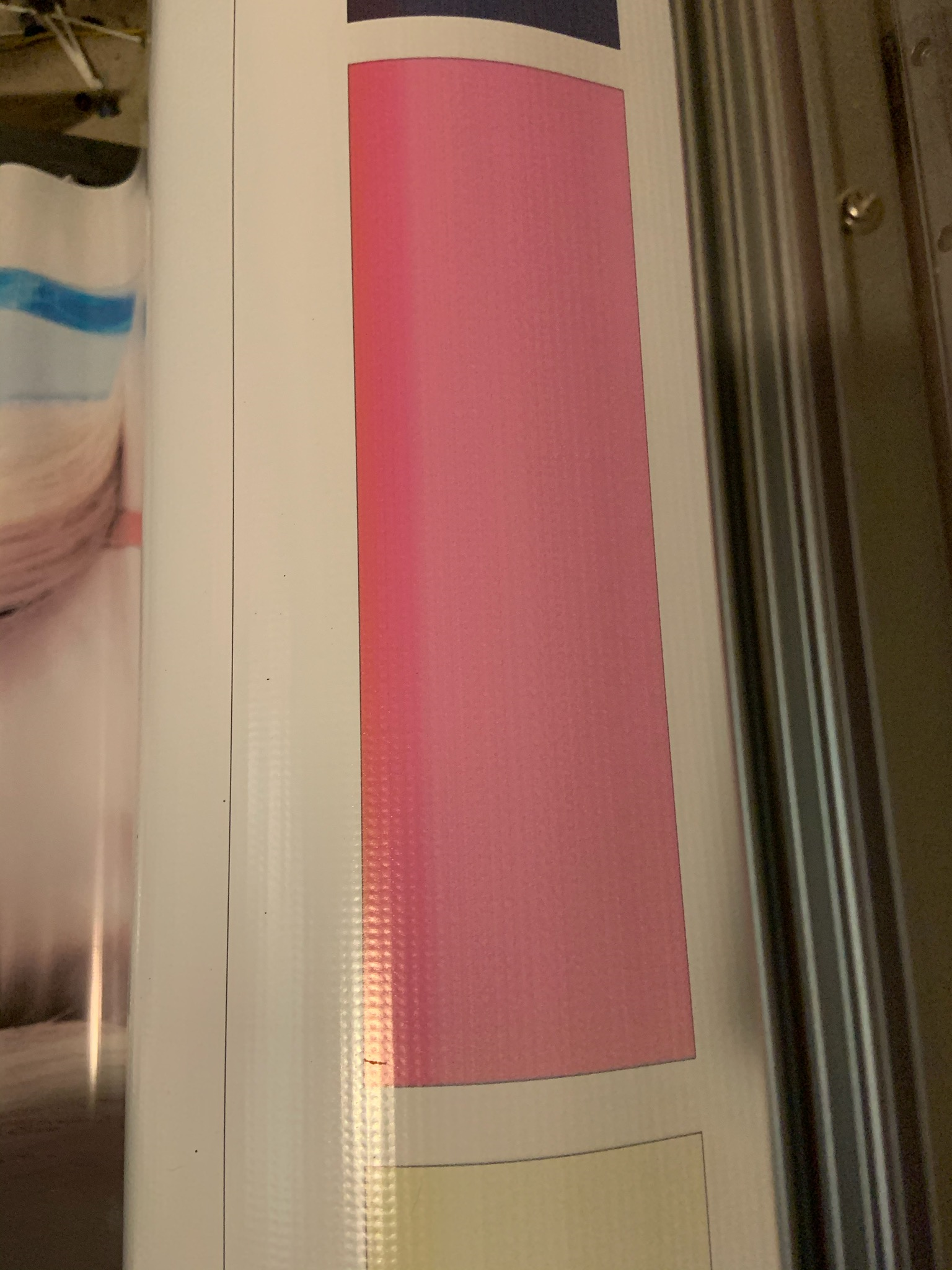

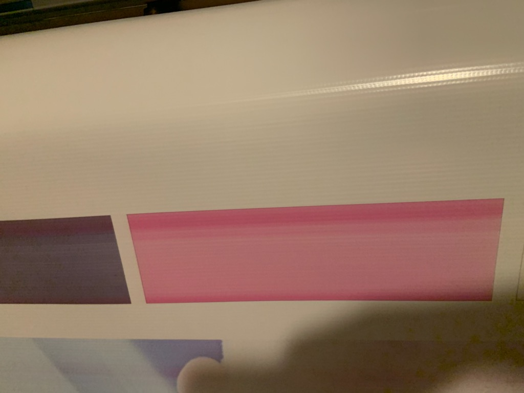

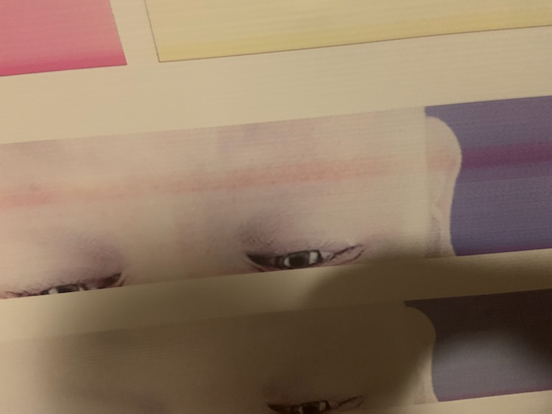

SP540i Not laying down enough ink
jayboe16
Everything is starting OK and getting washed out and light shortly after
Solventinkjet
DIY Printer Fixing Guide
Time to change the dampers and o-rings. Check your cartridges to make sure they have ink in them as well. Sometimes it won't flag the machine and will be empty and pull back on the system.
jayboe16
here is what i'm getting solid color bars of c - m - y - k coming out very very light and inconsistent.
