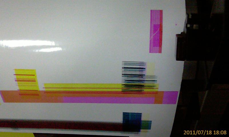

Hi.I have problem with cyan/black print.There is attachment.Does anybody knows where is problem?

How?I try crossover cables and problems from C/B goes to M/Y channel.So problems is definitely somewhere in C/B sections.I print last time before 10 days.Turn on,do some test print-OK.When try print job C/B uncontrolled print.
in sp 540 the yellow and magenta is in same head
you can revese the cables cards between magenta and yellow if the problem move to yellow here you have a problem in cable card you can check it if you repace it with another
but if the problem stay in magenta here you must replace the head
npelectronic
i crossover both cables from CB to MY and problems move from CB to MY.So that is indicators both printheads and printhead cables are good.Problem is somewhere behind.
bachaar
concerning problem with c/b return of main board check the fuses and the transistors C4131 ( NPN) the value between N and N YOU MUST FIND IT 36 OR 37
bachaar
