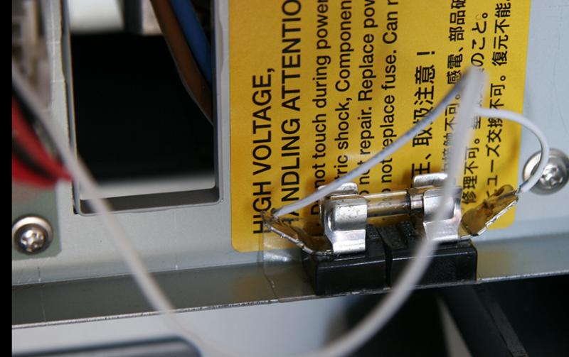

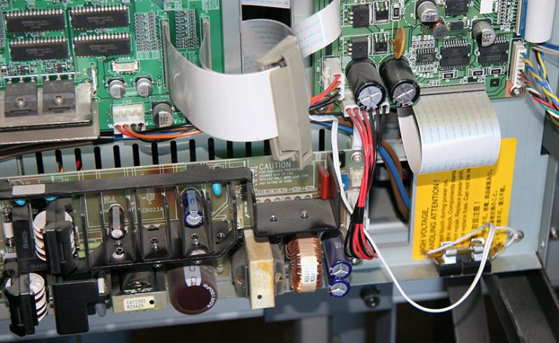

Here is the fuse hack I did...
The fuse I found locally was apparently an odd sized European
fuse so I had to cut a larger fuse holder down to size.
I used 2 sided tape to stick it to the inside flange of the printer.
I used liquid flux to make the soldering take on the fuse. That
is what looks burned...
Fuse is 1.6amp 250V fast blow. The original was 125V but the
voltage difference is apparently no problem.
