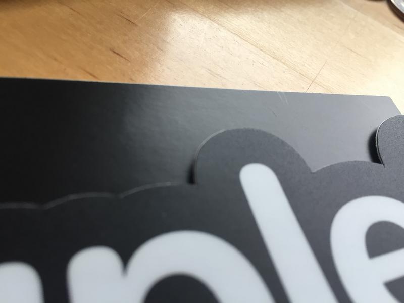

Thanks guys. The attached picture should do a better job of describing what I'm going for. If you look at the top decal using Oracal 210M, you'll see it has a slight texture. And there's no silvering. The bottom decal has the effect I'm going for. Flat, but no texture.
daenterpri
I just got off the phone with Oracal, and they think it is a type of silvering that I'm experiencing because the latex inks sit on the top more. So the matte no getting down into it everywhere is giving it the textured look.
I recognize regular silvering, fresh out of the laminator, but this is different than that. It looks like it's supposed to be this way, it's just not what I'm wanting for this project. Oracal recommended I find a matte film with a thicker adhesive.

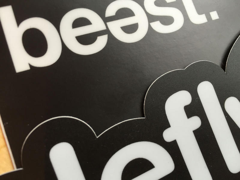

Ok guys, I'm still on the hunt. Here is a better picture of what we are trying to achieve (the bottom sticker). After a little more research, I'm starting to wonder if what we are dealing with is a thermal laminate. Which would be why none of us have had much experience with it since I imagine most of us are running heat assist at the most.
Again, the top sticker doesn't have any silvering. You are just seeing the mild embossing that gives it the matte effect, up close. If you were to hold that top sticker in your hand, you'd just think it was a nice matte sticker with no silvering.
What we are looking for is that bottom sticker's laminate which is still matte, but no visible embossing or texture. It's just smooth as butter.
What do you think?
