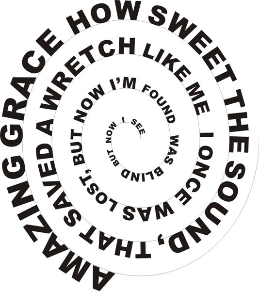

Can one do this in Corel? Putting text on the spiral is the easy part. How does one make the text progressively smaller. I tried the blend tool. but I guess it doesn't work with text.

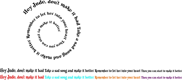

It looks like the text decreases in sections
Before you attach it to the spiral path, type your line of text and switch to the shape tool
Select a group of nodes and change the text size.
Repeat this 3 or 4 times and then fit the whole line to your path
It should only take a few seconds
