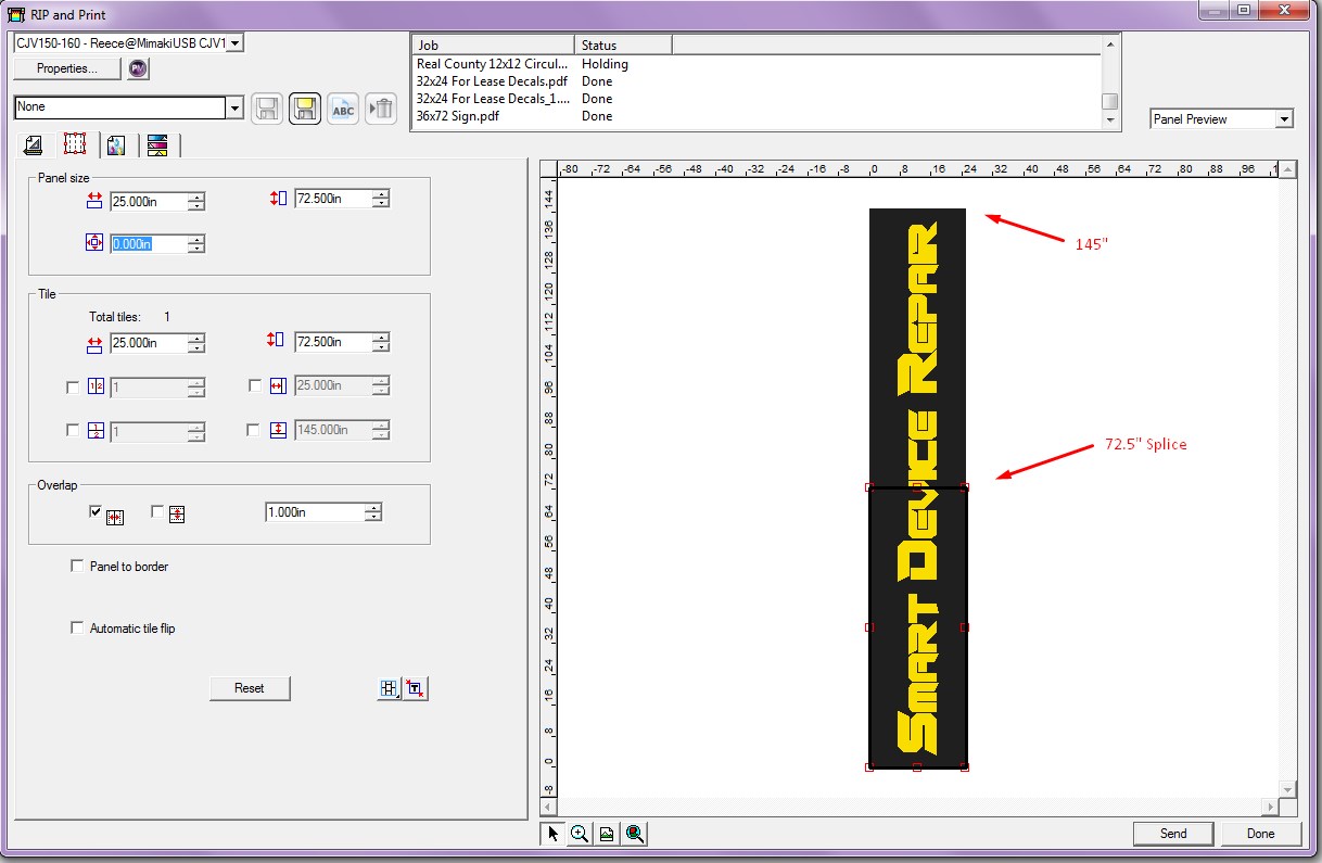

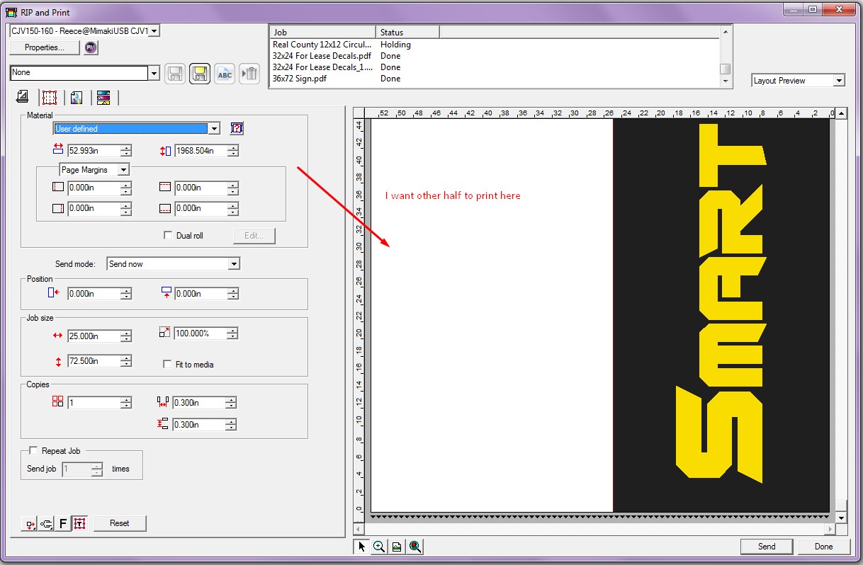

Sorry for the wordy title but basically I need help with this splicing issue. I have a 25x145" print but I need it to splice down the middle and print the other half next to it. I can't get the other half to appear and I was wondering if I was doing something wrong or if its even possible.
I'm also aware the tiles need to say "2" in order for that to happen but I don't know how to get the other half to scoot over there. I attached what I see on my computer screen.

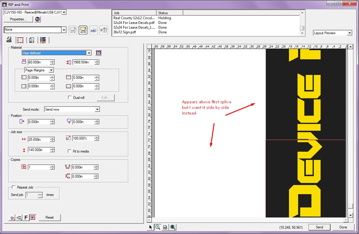

Thanks we are half way there! It turns out it's the CTRL key. Now I have 2 tiles but I still can't get the other half to appear next to each other.

I found a way to do it by making two separate print jobs and then nesting them in the Production Manager. I'm sure there is an easier way to this and I'd appreciate if anybody knows. :)

If you click and drag the first one to the left, then back to the right, does it drop the upper tile back where you want it? Wild guess, but corel and cutting master 2 used to do this.
I was going to suggest building two separate print files or making the tiles side by side yourself in your graphic suite of choice, but looks like you already did!
I gave that a try but it didn't work. I'm pretty sure I've done another job like this in the past and had no issue. Maybe Flexi was acting that day but regardless separating the print files did the job!
