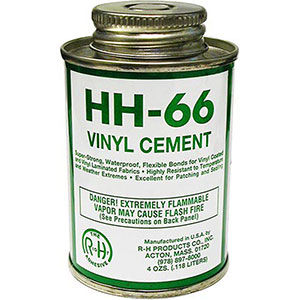

Get some HH66 vinyl cement.
Practice a little on some scrap material before you commit to your panels.
Easy money....
