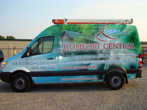

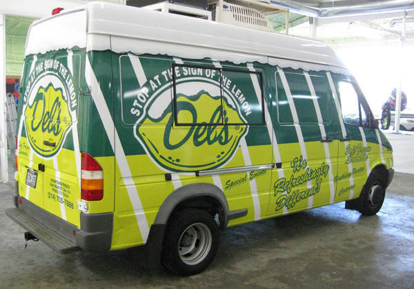

Is this an example of cutting the recesses?

Are you planning on letting those prints "Gas out" for 24 hrs before laminating??
Done a few with 3M 380, and it works good. I would still use a little primer in the radius's. I know they are expensive, but IF you are gonna "Roll in" with 380, you Need the 3M tools. If you use 380, you gotta use the Lam that goes with it too.
Anything else WILL lift out of the corners...Trust me.
Cutting the channels is a clean way to go too. Make Nice clean cuts and it looks good.
WHAT year van are you doing?? One recess or Multiple??

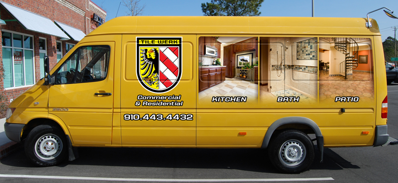

Prism1... I'm not sure of the year but here's the proof he signed off on for reference. It's an old DHL truck and was surprisingly in good condition without any graphics fading on the paint, etc.
