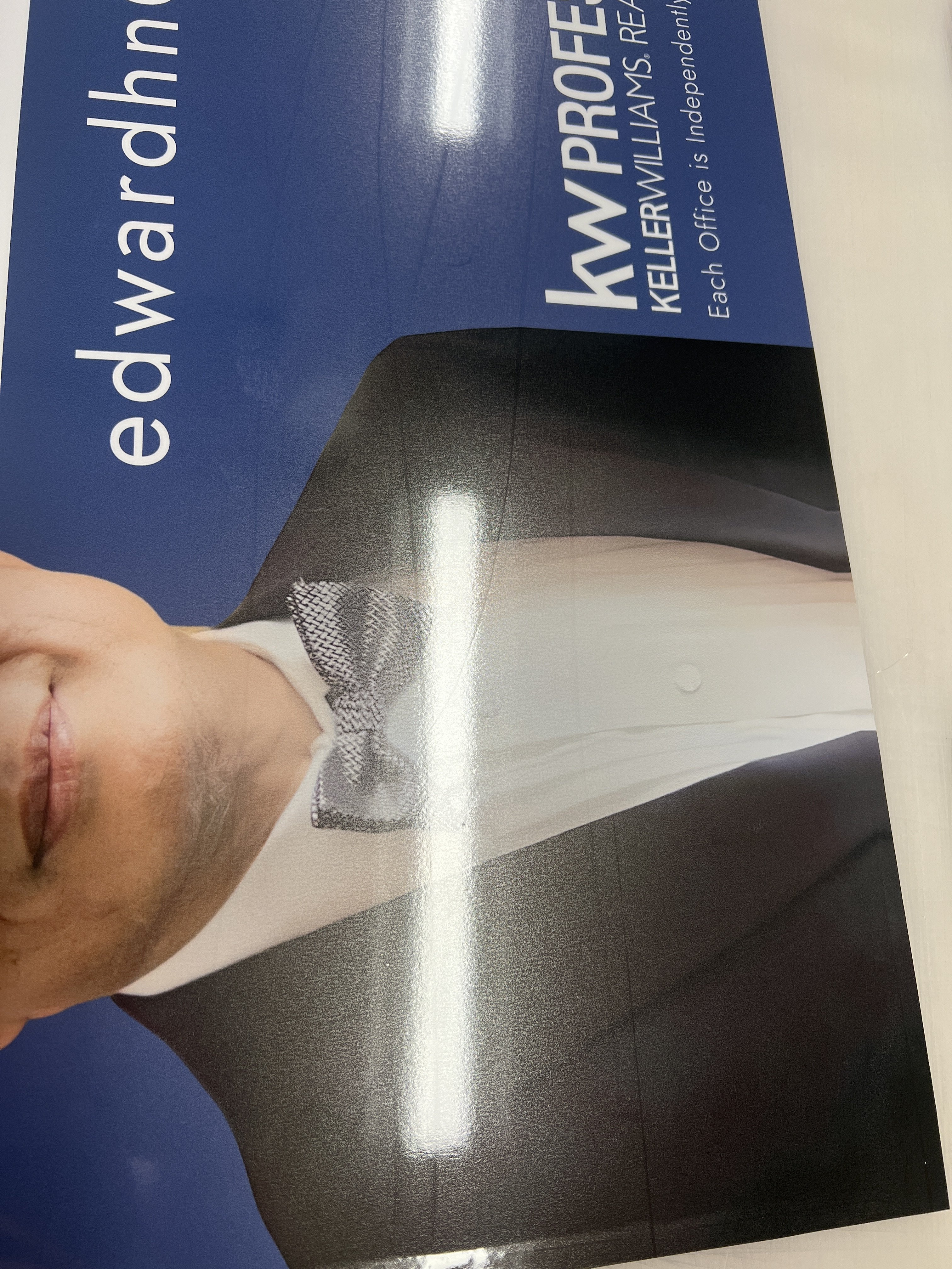

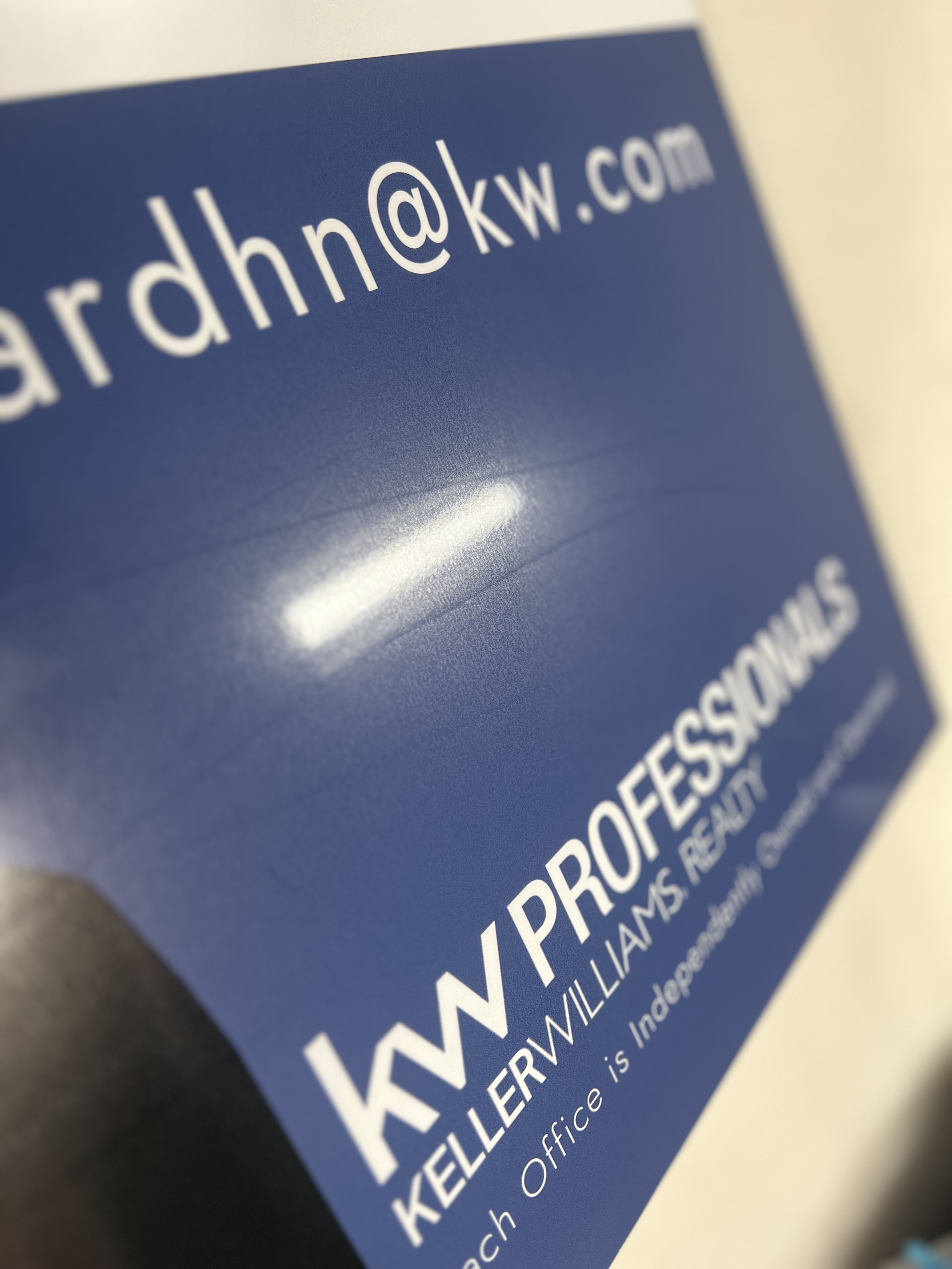

I’ve noticed these streaks on the print when I use the squeegee to mount the vinyl onto the ACM. I believe it’s just from the extra pressure onto the Overlam. It almost looks as if it gets rid of the “silvering” where I squeegee. Is that what’s happening here? Does this go away or does it stay permanently on the print?
This is a printed vinyl mounted on ACM and manually laminated with Substance Media’s Overlam. (I don’t own a laminator YET!)
Any help or advice on either preventing this or understanding what’s going on would be greatly appreciated! I’ve attached to images showing what I’m referring to

Yes silvering will normally go away over time.
The added pressure and/or heat from laminator rollers generally reduces 90% of the silvering so once you upgrade to a laminator it should no longer be an issue.

That will go away. As a tip, when I apply printed vinyl I usually wet my felt squeegee down and that cuts down or eliminates the "scratches". You can see them more on black and darker ink colors than on white.
Oh awesome! Thanks for the tip! I’m just slowly building up for a laminator soon! I’ll try this in the mean time!
Thanks for that! I figured the heat would help! I’ve tried going harder on the pressure for the manual laminator but I end up just wrinkling the Overlam bc the pressure was too tight

Silvering always goes away, just a question of how long you / your customer are prepared to wait.
Some laminates have a softer adhesive which makes silvering less noticeable, but they can be prone to shrinkage and glue lines on the edges.
Here's THE BIG TIP though !
Once your print is laminated, roll it up and put in on the dash of your car or truck in full sun for an hour - presto, silvering gone.
In warm weather 30 minutes will do it.
Over here (and Texas as well I imagine) it'll hit 50+ degrees C in your cab with the windows up.
KEYSER SOZE
If it's already mounted on the ACM, put it in the tray of your truck with the tonneau cover closed.
