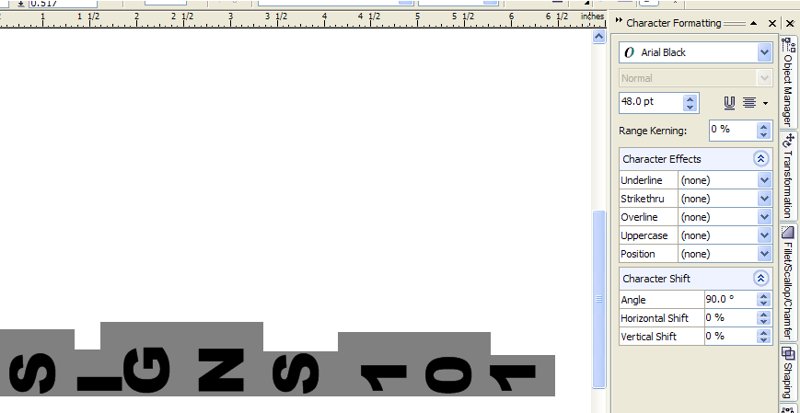

Type your text then shift-highlight it.
Open your character formatting docker
look for Character Shift > angle
Or you could just add a return (enter) after each letter.
wayne k
guam usa
