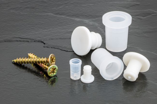

what adhesive should i use for 12mm Makrolon water jet cut, vinyl backed letters. I backed the letters with 3M 80 series. I'm using standard locators (see image). It the male fixing to the vinyl on the back of the letter i need to sort. It's an outside sign. 3M vhb tape? Hot glue gun? or another?...

Had to look up 12mm and that would be .5" thick material, I am assuming that it is the thickness and not the height, which is going to make a weighty letter. What kind of material are these attaching to on the outside. Are these letters clear and that is why you backed them with the 3m as you mentioned and they cannot be tapped. Hot glue, if you are a major scrape booker and have some new stuff that is stronger than what I am use to, no. VHB tape, do not know how much surface area of the attached pic but you would need a fair amount of surface for that to work plus some adhesive with them would help if you have the area. Epoxy, and not the consumer kind they sell in Home Depot, might be your ticket and there might be someone else on the forum to give you a better idea. More pics of the actual letter and size and what they are adhering on to is also helpful.
All depend how big is the letters. If they more than 12" tall I would make 1/8 thick acrylic pads with bigger surface area and glue them to the standoffs with weld on 4 and then silicone them to the letters.

Those hangers he is showing in the OP look like the ones they give you from those sign shops on the web that sells signs like that to the consumer to install themselves.

Checked a bit online too. It was the locator sticking to the vinyl i wasn't sure on. Anyway gone with more locators now and 3M tape (the strong expensive sh*t, can't remember the code name). The letters were 12mm thick and 400mm high. Not too heavy though.
It's a job that's close by and not a problem to make changes to if i notice stuff happening down the line.
