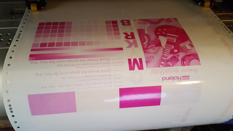

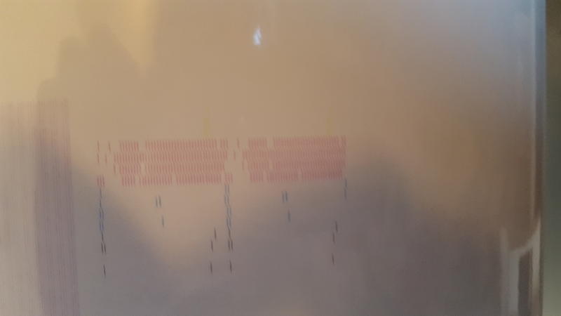

I let the heads soak overnight and results are about the same, I changed cap tops as well. If some of the lines in the cyan, black, and yellow show up is this a sign the head could still be good or can certain sections of the head be clogged while a few spots work?
Thanks.

player
Are you familiar with drawing ink from the heads with a syringe? Be careful not to pull too hard and blow the membrane and ruining the head.
Are you familiar with the technique of BARELY touching the bottom of the printheads with a cleaner soaked swab? Zero pressure, zero movement, and just let the capillary action draw the cleaner into the head.
Lastly, I find with fresh caps, letting the head sit and do regular cleanings twice a day for days can yield more results than working at it for hours and hours at a time. I have found prolonged sessions can make them worse.
Again if the dampers and heads are full of cleaner, it would be a good way to try to save the heads.
premiercolour
Merchant Member
After 4 dampers, 2 cap top were changed. I would look into the pump and o rings on the ink line underneath the nut to tighten in to the damper. I would buy four cleaning cartridges and perform "head wash" to really drain all the ink and fill the ink back up. I spoke to a technician that he admitted to destroy a few good heads due to manual drawing ink. Use the machine factory head wash is the best.
