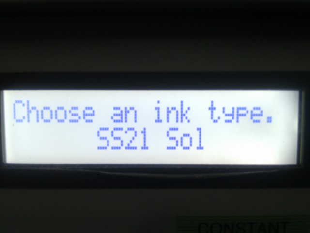

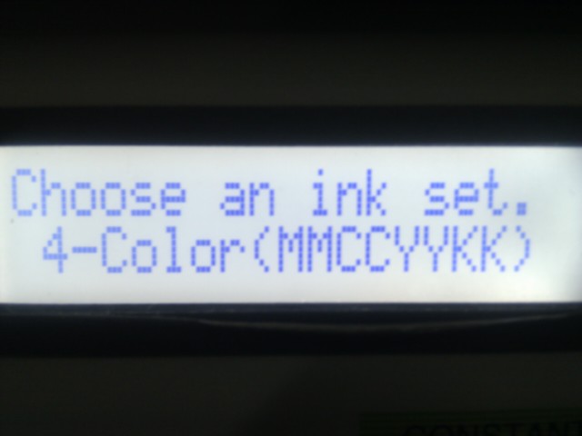

Good evening everyone,
I'm new to this forum and I hope a solution to my problem. Thank you
On the control screen, "Choose an ink type" SS21 ground OK.
"Choose an ink set" 4 color OK.
And then appears: "-M-C-Y-K," when I press OK, nothing that happens! The machine remains in this order.

For the initial ink change/fill it is asking you to insert the ink cartridges. It sounds like you have 1 each in slots 2, 4, 6, and 8. If you put all 4 in slots 1,3,5,7 it would probably show M-C-Y-K- and if you put all 8 in it should show MMCCYYKK. At least that what it sounds like from your post.
Do you have 2 each of CMYK SS21 ink cartridges that all have ink in them and not expired?

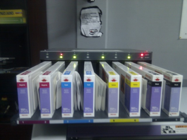

I put like you had tell me the empty cartridges in the location that remains, but to no avail, nothing that happens!

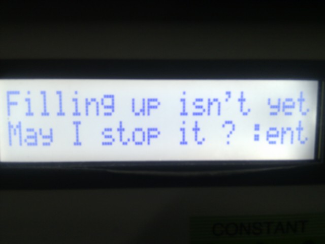

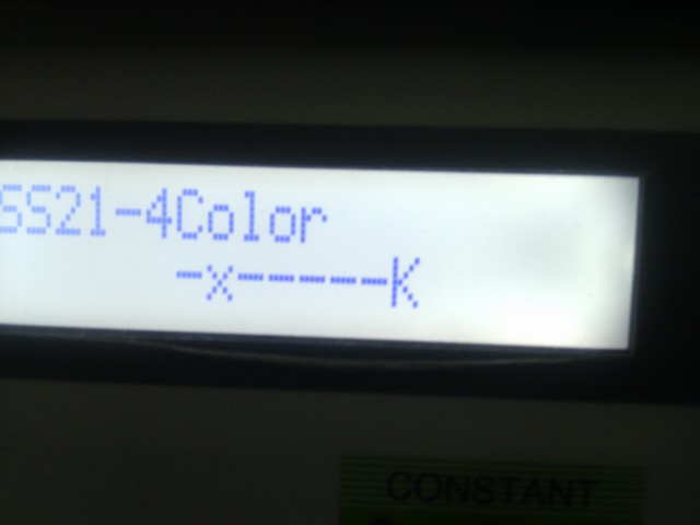

In the image dispay control of CJV30
SightLine
Based on the pictures it is now telling you that the #2 Magenta cartridge is not able to be used and the #8 black cartridge is not being detected at all.
