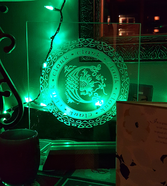

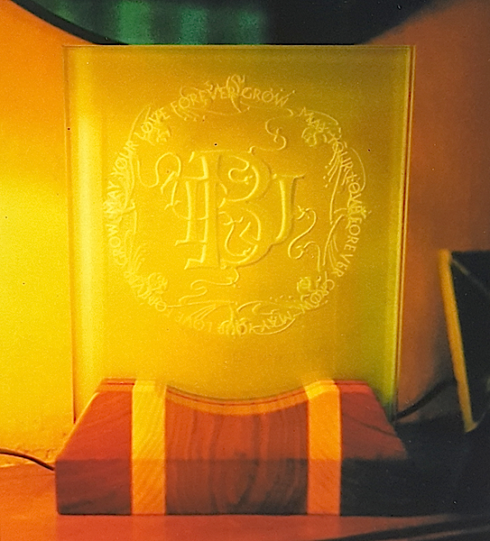

Its been quite a few years since I've done some glass etching and one of our local glass companies needs us to cut some stencils for them. I hate to buy a whole roll of stencil for a tiny job that isn't going to be carved, just etched.
I used to just cut Gerbermask and it was fine for standard etching.
Has anyone used it also, or maybe just a piece of laminated calendared vinyl as a resist?
I did these pieces with just GerberMask and it held up fine even for the deeper blasting.
