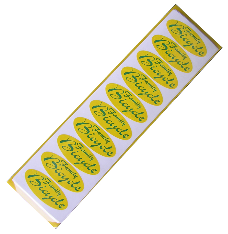

This is how we finish our labels. Weeded and in vertical strips (which customers seem to love) and then shrink wrapped to a piece of coro. Looks great for clients who pick up and ships undamaged in your choice of box or padded envelope. The label layout is the client's and not mine.

It's a good policy to do a good job finishing your RTA work. It shows pride and caring to the client.
