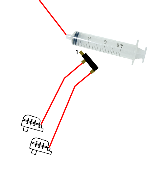

I'm pretty sure what is the problem. I had it in my machine The problem is that there're air in the tubes.
When you do a little charge the pump suck the ink throught the dampers and it filles a little. After that, if you disassemble the rear cover of the machine, you will see that the ink turns to the cartridge. It sounds very easy, but no technician knowed the problem, very shameful.
Be brave, take your time and follow this steps, I'm sure you will solve the problem and your machine will come back printing. :smile:
1 - Disassemble the rear cover of the machine and you will see something like the draw I attach.
2 - Disconnect the cooper thread from the part #1, beware not to lose a little o-ring.
3 - Take a syringe and suck very slowly, stop and look if the ink returns to the cartridge. If not, here is the problem.
Tell me if the ink stops or returns to the cartridge and I will be very happy to help you.
Hope you understand me explanations, limited by the language.
Bernina.
p.d: If you call a technician is very possible it will tell you to change the pump, don't do that, please.
