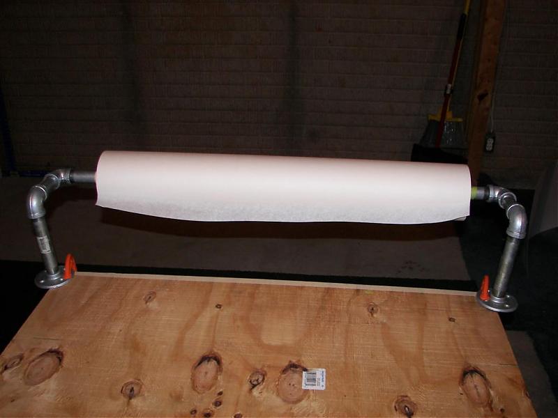

Hey everyone, I have been pre-masking everything by hand for a while and am interested to see what the forum thinks is the best tool to “upgrade” to. I have used the weber-made masking tool before and like the idea of the double shaft version, but think it’s ridiculously expensive for what it is. I have a friend who made a cheapo version ($35), with the same basic idea but using plumbing pipes (see attached).
