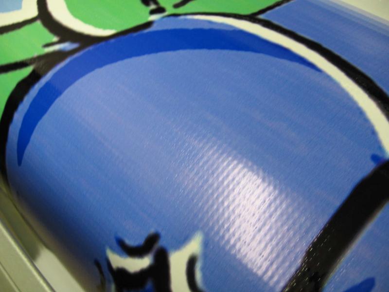

Hi all.
I gotta report I'm getting the same streaking on a job I'm trying to print with my new CJV30 through Signlab.
The color is dark blue C90,M70,Y10,K20 straight CMYK with no colour correction.
I've tried 8 pass, 16 pass, hi speed, normal speed, unidirection all have the streaks.
Also if you look real closely at pic 1 you can see ghosting of the lettering which is happening before it gets to the actual lettering.
This leads me to think the data is getting corrupted somehow.
The nozzles are all firing 100% but the color varies as it prints. You can see the color difference in some of the passes while it's printing. (see pic 2).
I tried printing it through Rasterlink and it didn't streak (but the color was a lot different).
I converted it to a bitmap in Signlab and it printed smoothly. Likewise I converted the color to RGB in Signlab and it also printed perfectly.
So it's only streaking when sending a CMYK color through Signlab.
I turned on color correction CMYK profile and it still streaked although it was a different color.
So the solution for me is to choose these colors as RGB.
I printed an RGB swatch and they are all perfect as are RGB bitmaps (thankfully!).
Perhaps this is the same problem that Flexi has? It looks the same, and so far has only happened with this dark blue for me.

iSign
4 years ago, I learned to print RGB files, and learned that the vast majority of others have learned the same. Haven't printed a CMYK file since!

MachServTech
The only benefit associated with setting up your files in RGB is that you will have a slightly larger color gamut if your ICC will allow it (media profile), on some matte materials or papers your gamut is crap anyway. Overall its a net benefit, but it will not fix banding issues.
Onyx has a 30 day free demo that would be useful to eliminate RIP as the cause.
MachServTech
Banding or streaking comes in two axis. Carriage direction and Media feed direction. The causes for each are different. Carriage direction banding is caused by printhead nozzles, bad dampers and capping station malfunction. Media feed directional banding can be caused by carriage bearings chattering making a vibraton pattern in the print, rollers applying too much pressure and heat on some medias (unusual) and media contamination.
Start by eliminating the printhead, damper and capping station issues, then move out from there.
Printers are much like cars, if you forget to periodically maintain them they will remind you in a bad way.
Dampers, Caps and Pumps every year or two if possible....budget for it.
ColesCreations
Listen to iSign...
We'll try RGB.
I don't think this streaking is a bad printhead or damper or pump, because it's recurring at exact intervals, same with 2-pass or 16-pass. Also, "no color correction" usually fixes it. It may just be that we need to print RGB, and accept it as the solution. I hope it works!
mimakitech24
i am having same issue, thinking it may be profile related at this point...same file with a tweaked color value in preflight and there was no streaking...
