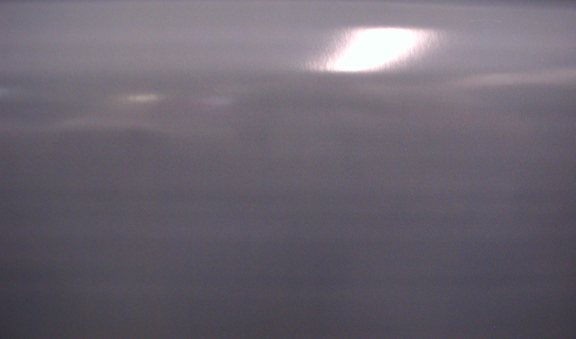

So hopefully somebody can help. I am printing on a cjv30-160, and keep getting banding issues. I'm using flexi 8.6 to rip, and trying to print a solid gray. The issue I'm having is it will print lighter "strips" across the image, meaning about an inch will be the correct color, and the next inch or so is slightly lighter, then back to correct. I attached a picture, but not sure if its very noticable here. We tried cleaning the encoder strip, adjusting the feed rate, different profiles, different pass rates. Does anybody have any suggestions as to what it could be? We are out of ideas over here. Thanks guys!

mudmedia
gradients in flexi = nightmare.
Try either flattening the file and ripping as a tiff or if you have photoshop try creating the gradient in photoshop and seeing if that fixes your gradient step issues.
jimmeth411
It isn't a gradient I'm trying to print, its a solid gray block. To be honest, I don't think we've had any problems with gradients or other solid colors, just this gray.
mudmedia
is the color associated with a logo or can you try a slightly different cmyk code for grey to see if it still is there?
jimmeth411
yeah, its actually a pantone color that we have to match. But we haven't tried changing it at all to test. We might have to try it and see how it looks.
jimmeth411
So I tried changing the values ever so slightly, and it still has the same issue. 1 inch of correct color followed by an strip slightly lighter. someone please help!
