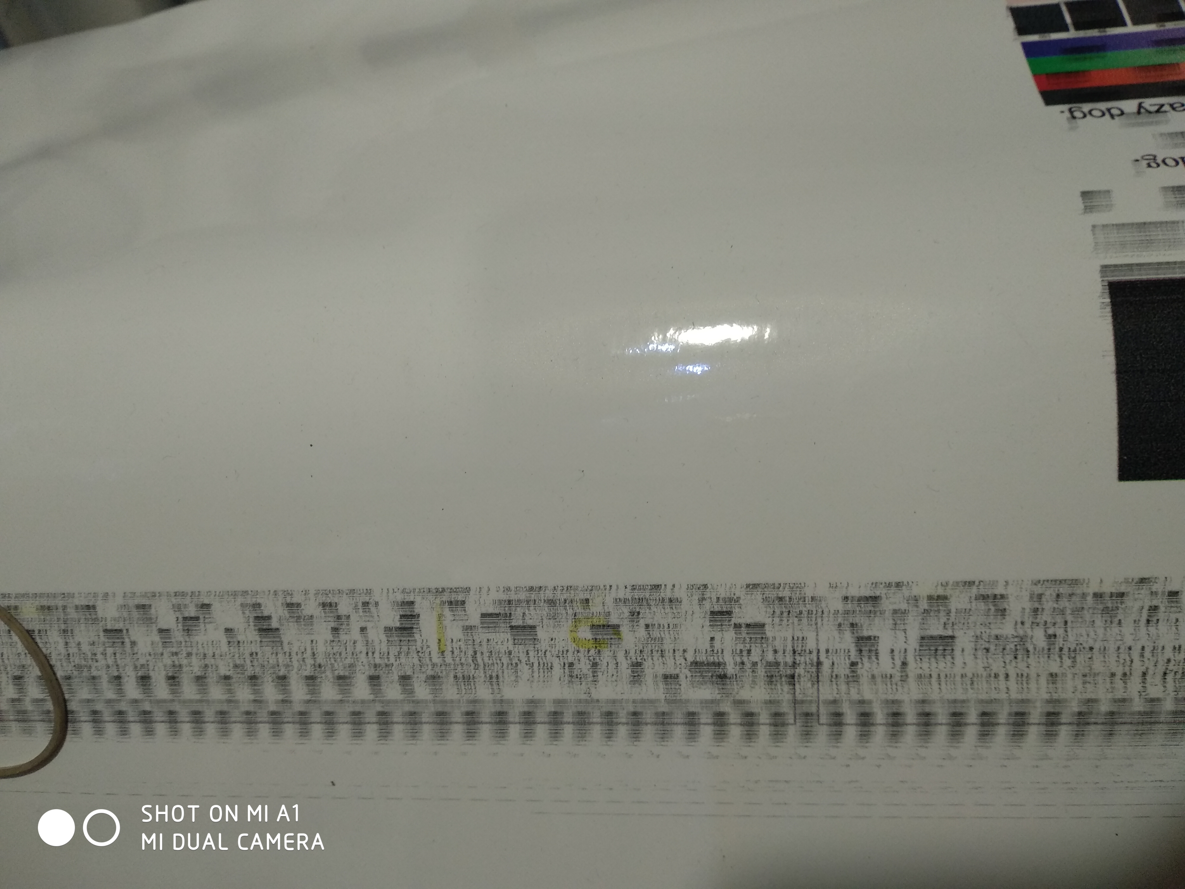

Good evening to all and happy new year. I wanted your help if anyone had a similar problem or knows what might be causing these horizontal lines in print. Thanks

Looks like an encoder issue. I would clean the encoder along with the sensor. If that doesn't do the trick, replace them. I've seen that pattern on a locked DX5 head before but your machine uses a DX4 heads and as far as I know they never made locked DX4s.

thanks a lot for the response. I have a question what do you mean when you tell me about locked dx4?

Epson made different versions of the DX5 head that would only work in certain machines. Usually when you put the wrong head in a machine it would print a similar pattern to your test print. I don't think they ever did it with the DX4s though so you issue is more likely the encoder.

Thanks a lot for your time. What you told me was valuable, I will follow your advice !!

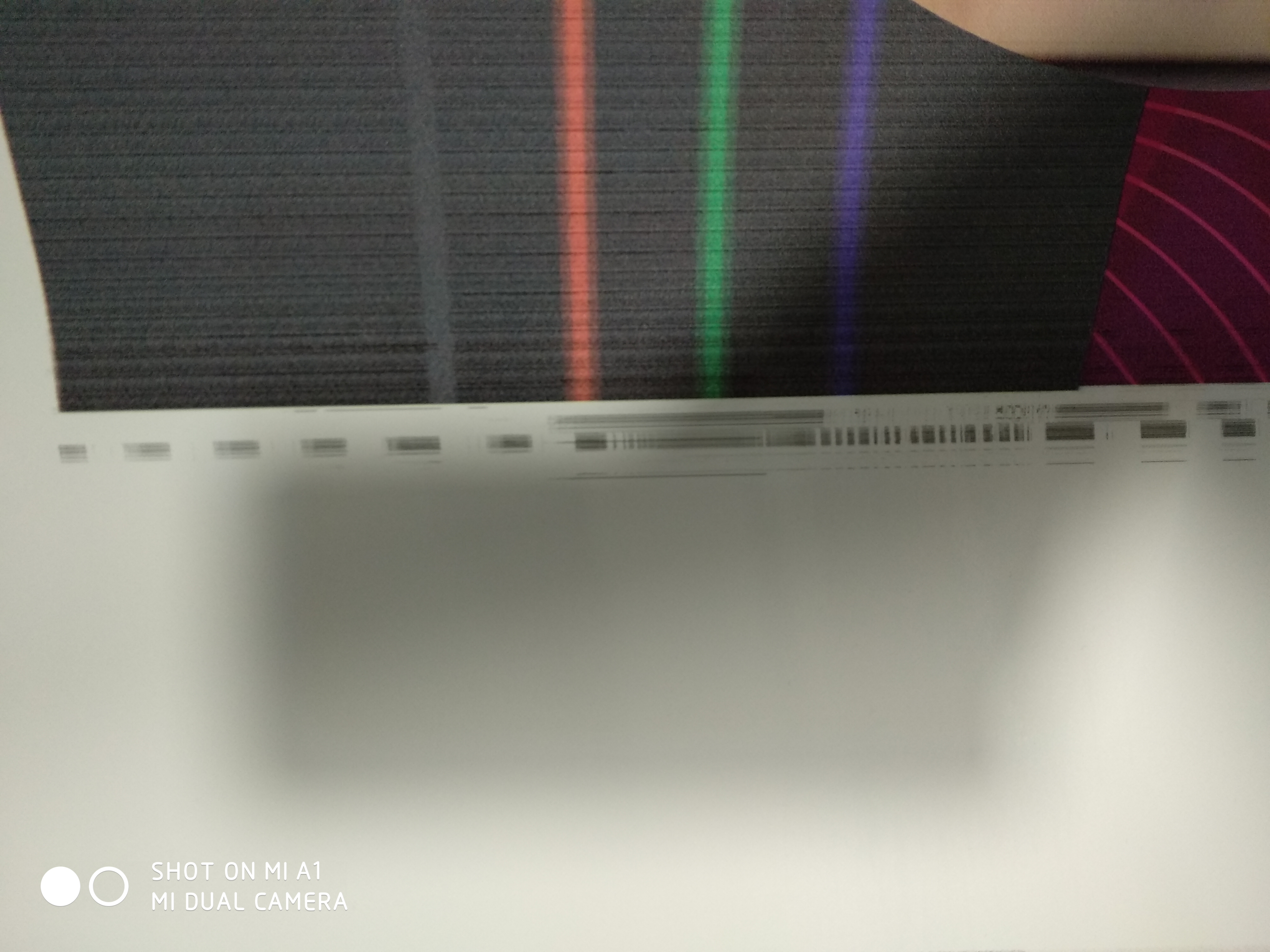

good evening again, I wanted to ask you if you have any other idea of what might be going on. I changed the movie and I still have the same problem. the same black lines are printed again
