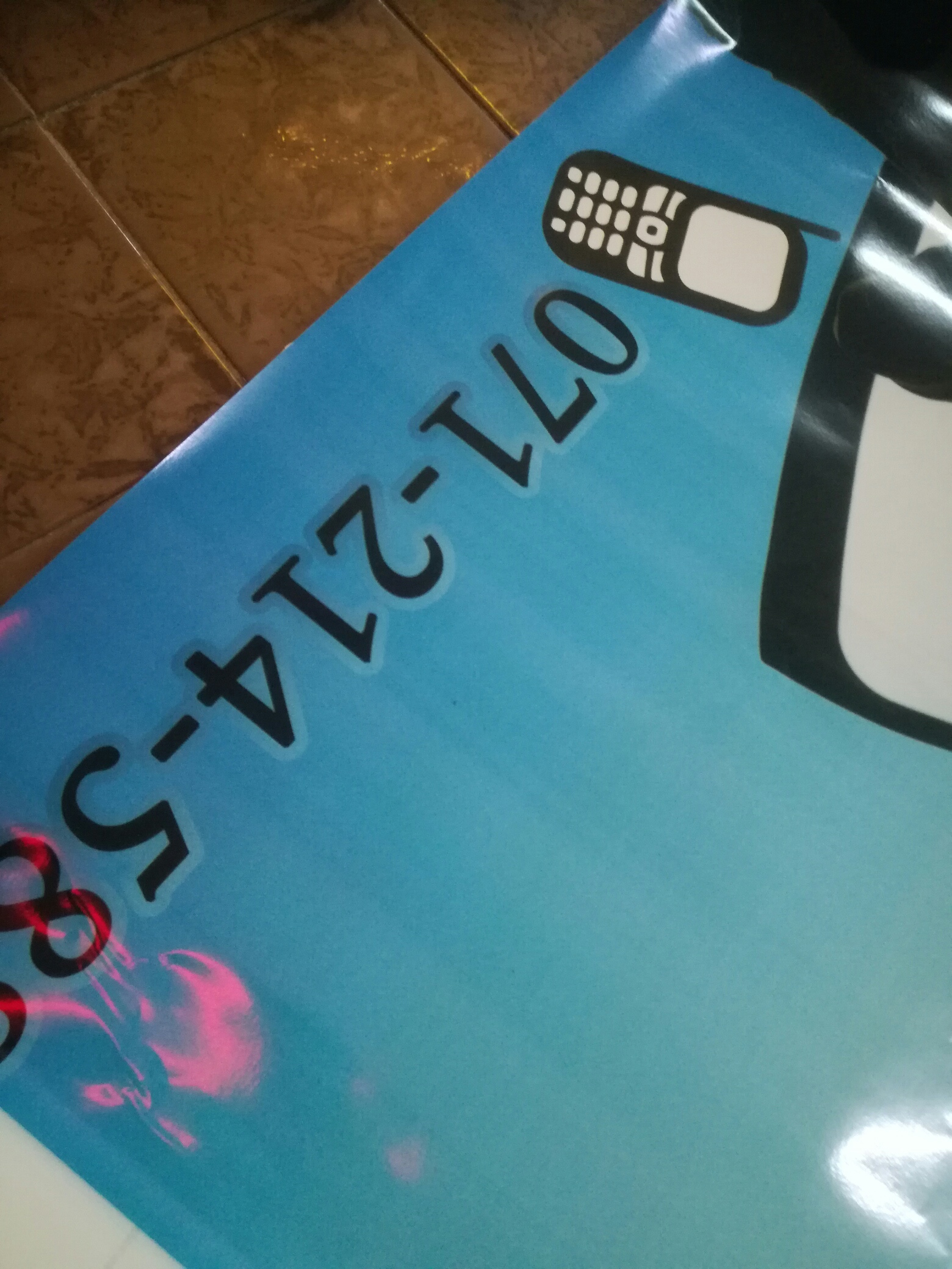

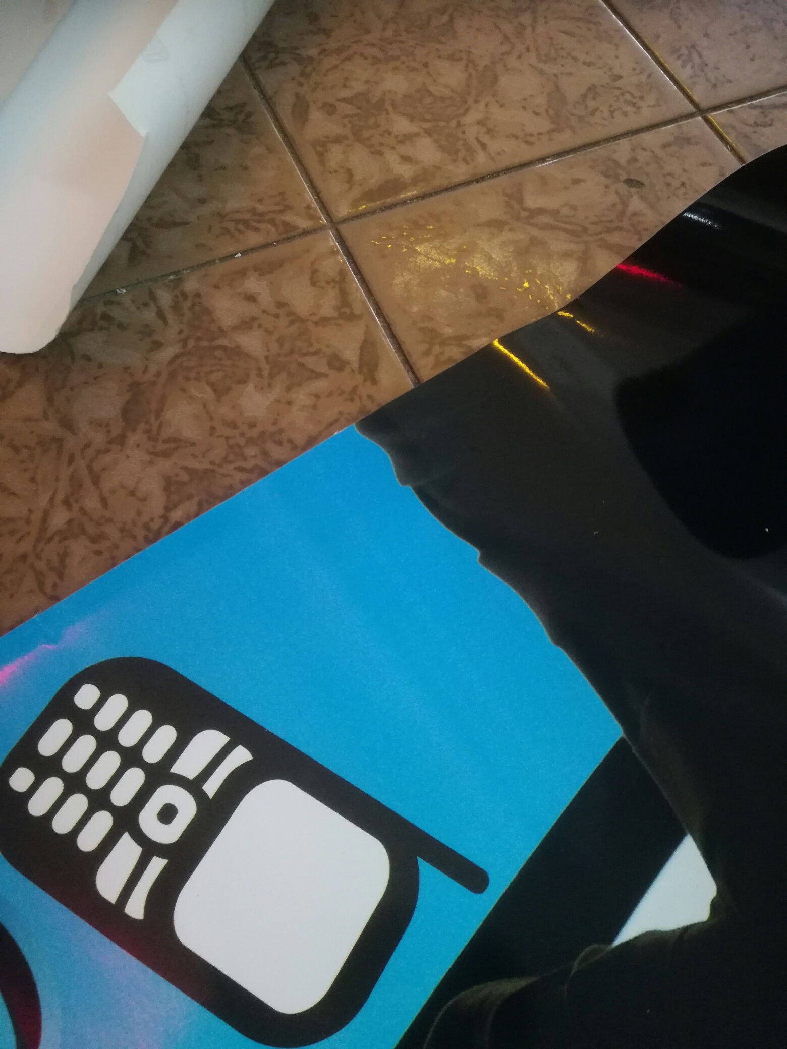

Hi there I struggle with these lines i get on color prints which are bright. It can be noticed on light colors and not that much on fully covered colors. Its a new head, nozzle check is at 100%. cleaned the encoder strip...new pump, new caping. Dont know what to check else. Can any one help?

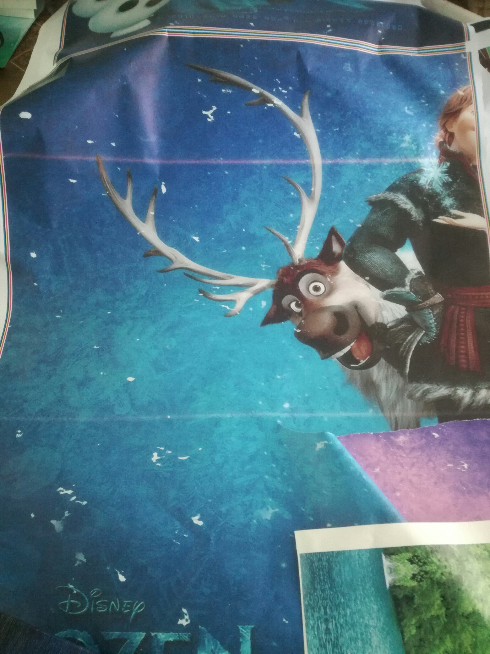

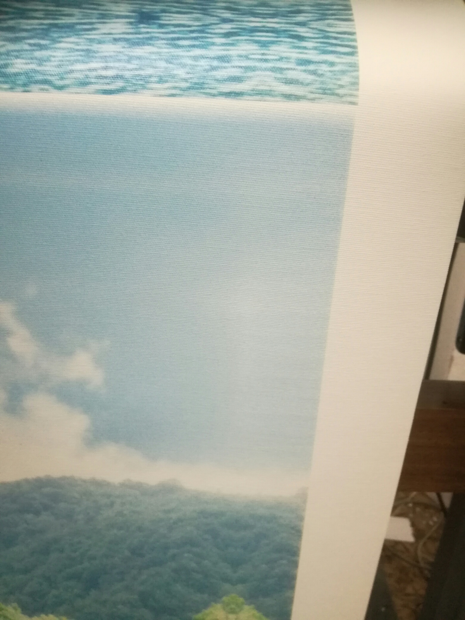

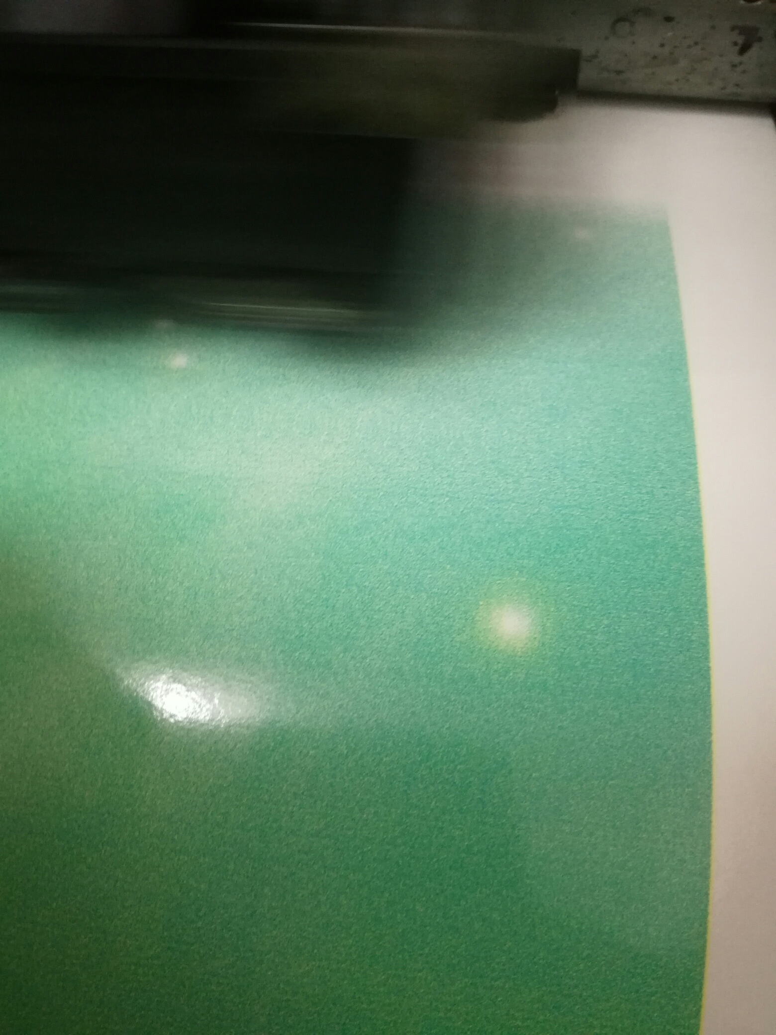

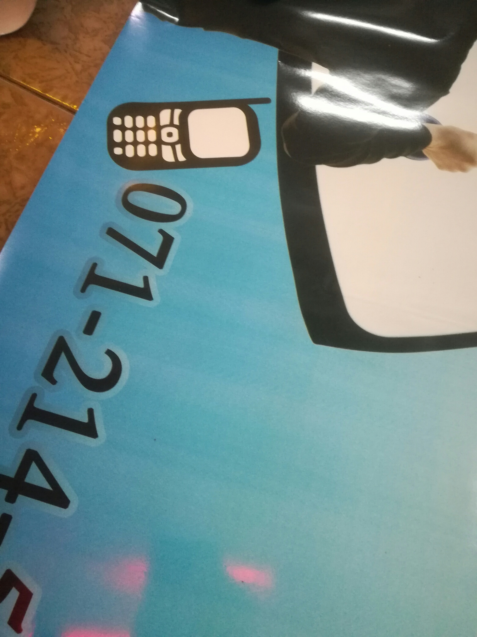

The lines are horisontal, the way the printhead travels.

GraphicsSource
Have you tried a different material? Or looking at the step calibration to ensure it's advancing properly.
Sent from my Pixel XL using Tapatalk
ams
Do you have LC, LM or LK? That plays a part in fixing that issue. CMYK only will often cause that. Also make sure there are no fibers or anything on the printhead.

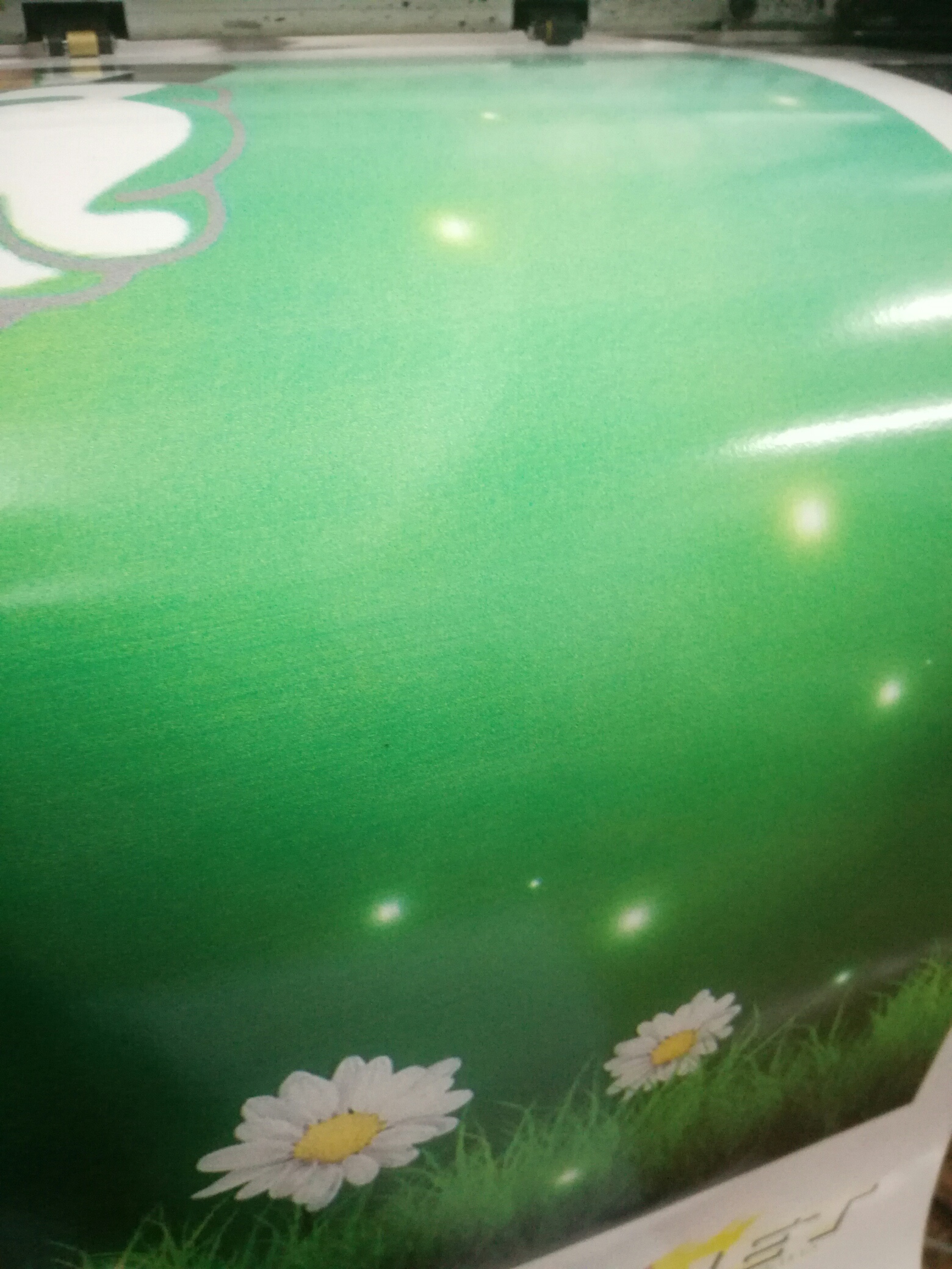

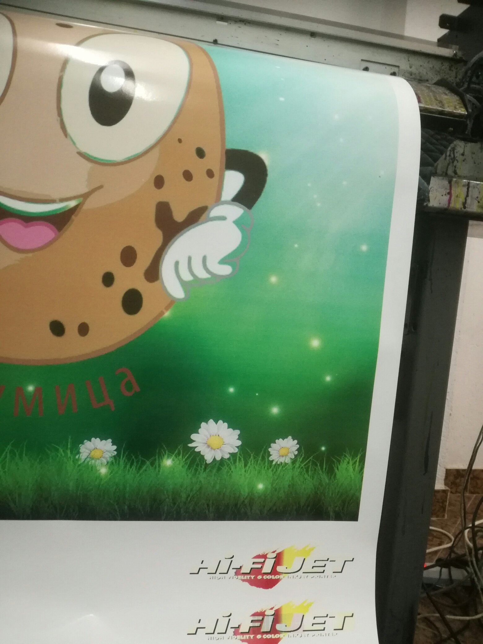

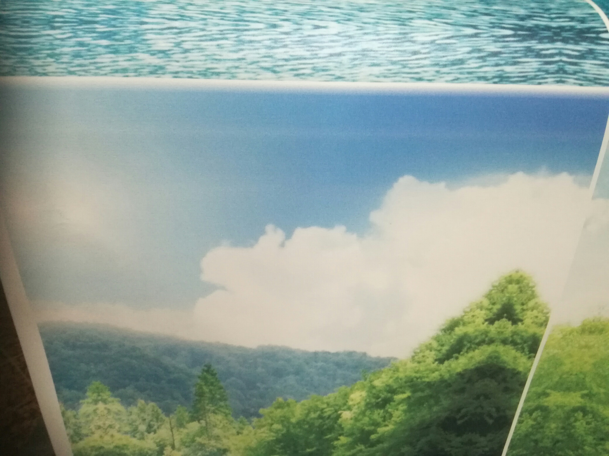

I am not using the LC and the LM. I changed the printhead and this fixxed. now this thing happnes. It prints fine, and only on the right side there is 1cm banding, after 70cm there is 4 cm banding. And when the head goes to the caping stations to refill, and restarts the printing i get this horizontal line like ink drop out for 10mm and after that it continues to print normal.
