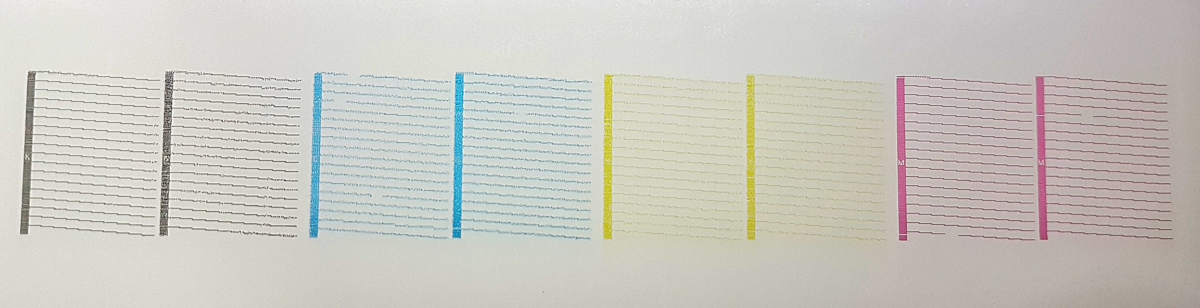

Since few weeks the black started to give us problems...visible on nozzle check but also when printing black parts.
Here's the nozzle status:

Seems more like an electrical problem with the first two lines of nozzles.

Looks like the black channel driver has a problem. Could be an incorrect printhead voltage or a faulty electronic component (transistor, chip) on the main board.
This kind of problem it's hard to repair remotely.
