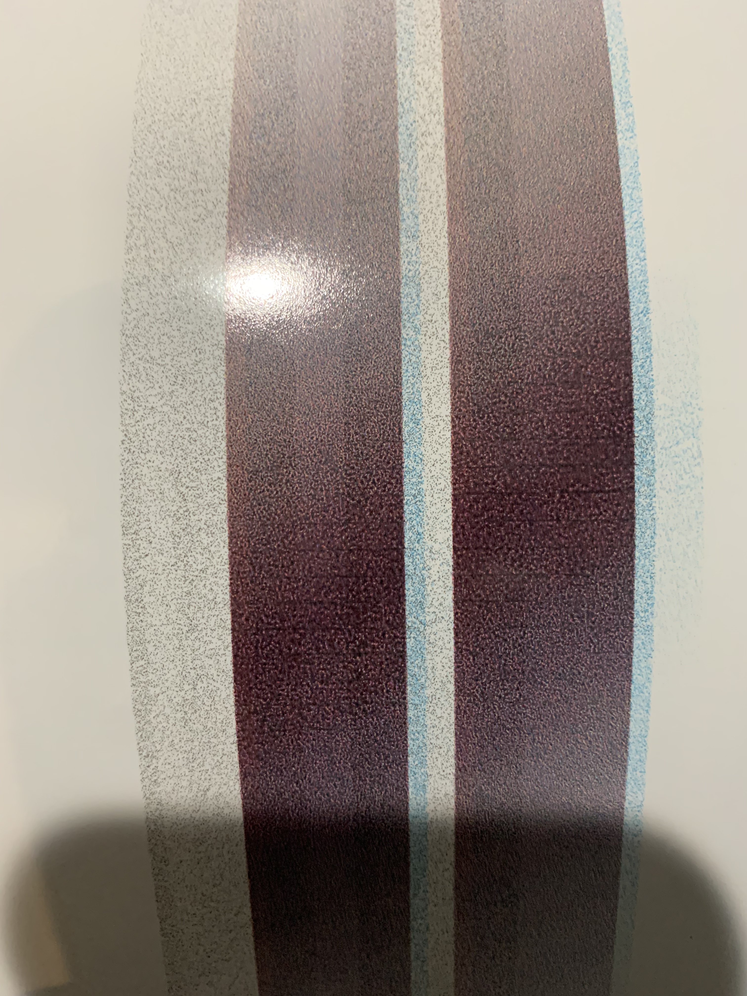

Hi guys. I’m getting a weird shadow effect when I print. If you look at the image these two gray bars should be just two gray bars. Everything I print has been coming out this way. It is double printing for some reason offset by about 1/2” to the left

Thanks. I did not that I know of. That’s kind of what I thought it was. It was printing 100% perfect and I unplugged the printer for a week in case we had severe storms . When I got back that’s how it was printing
midnightmadman
I might try doing a test print from the machine. If that’s good it means it’s somehow in the rip or electric issue from the data ?

If it were me I would turn the printer off, unplug it, hit the power button, wait 15 minutes, disconnect the head and trailing cables, air dust the terminals, and then re-install the cables. If that doesn't do the trick, it's probably a bad head or board.

Test prints use the largest dots which are the easiest to fire for the head. When you print a file it uses multiple sizes of dot which is where you will start to see problems if there are any. Hopefully it's just a damaged or dirty cable!

To me this looks like a board or other electrical hardware issue. Encoders, both readers and lines, could do this - but not to this degree. What machine is this?

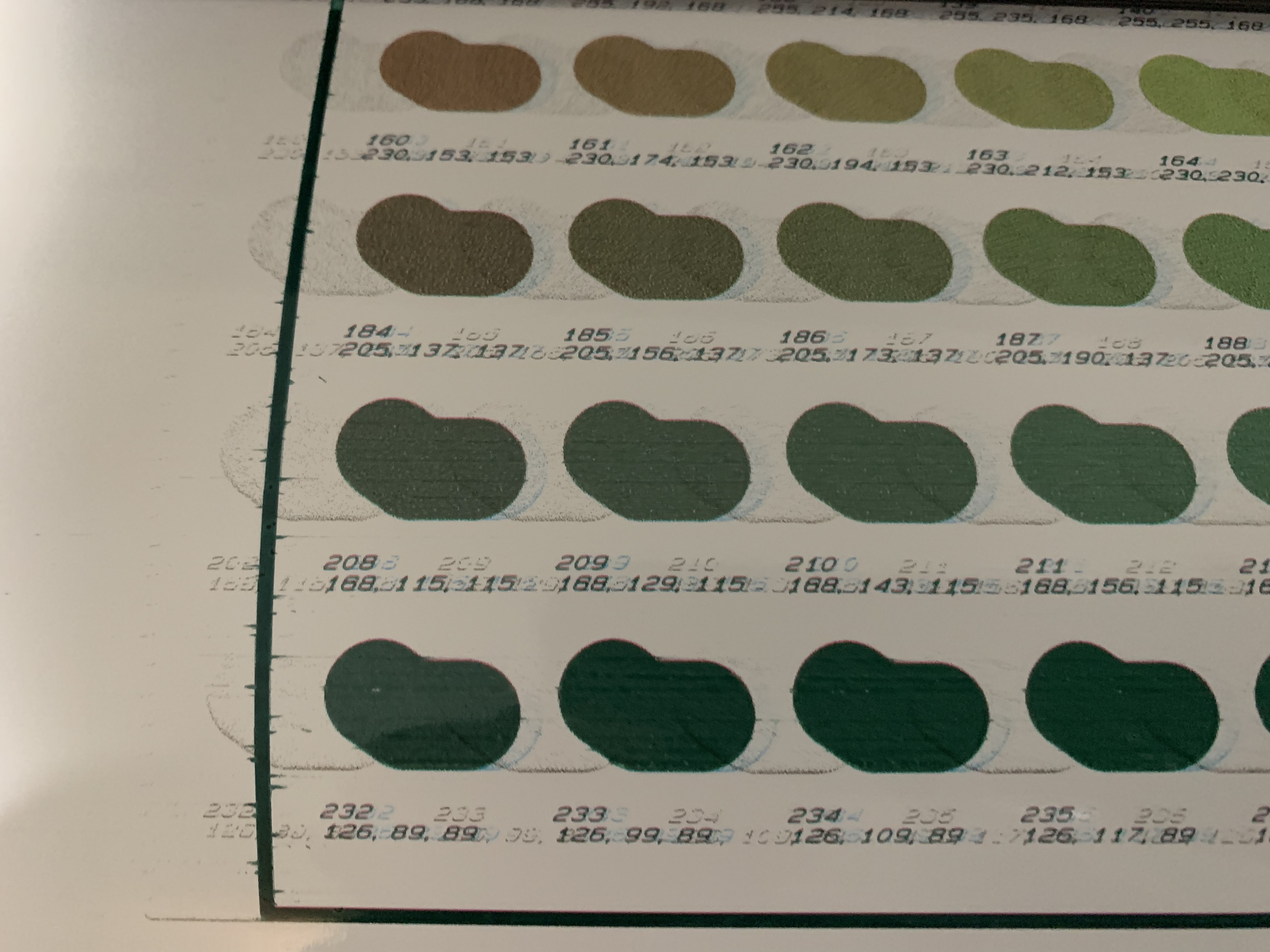

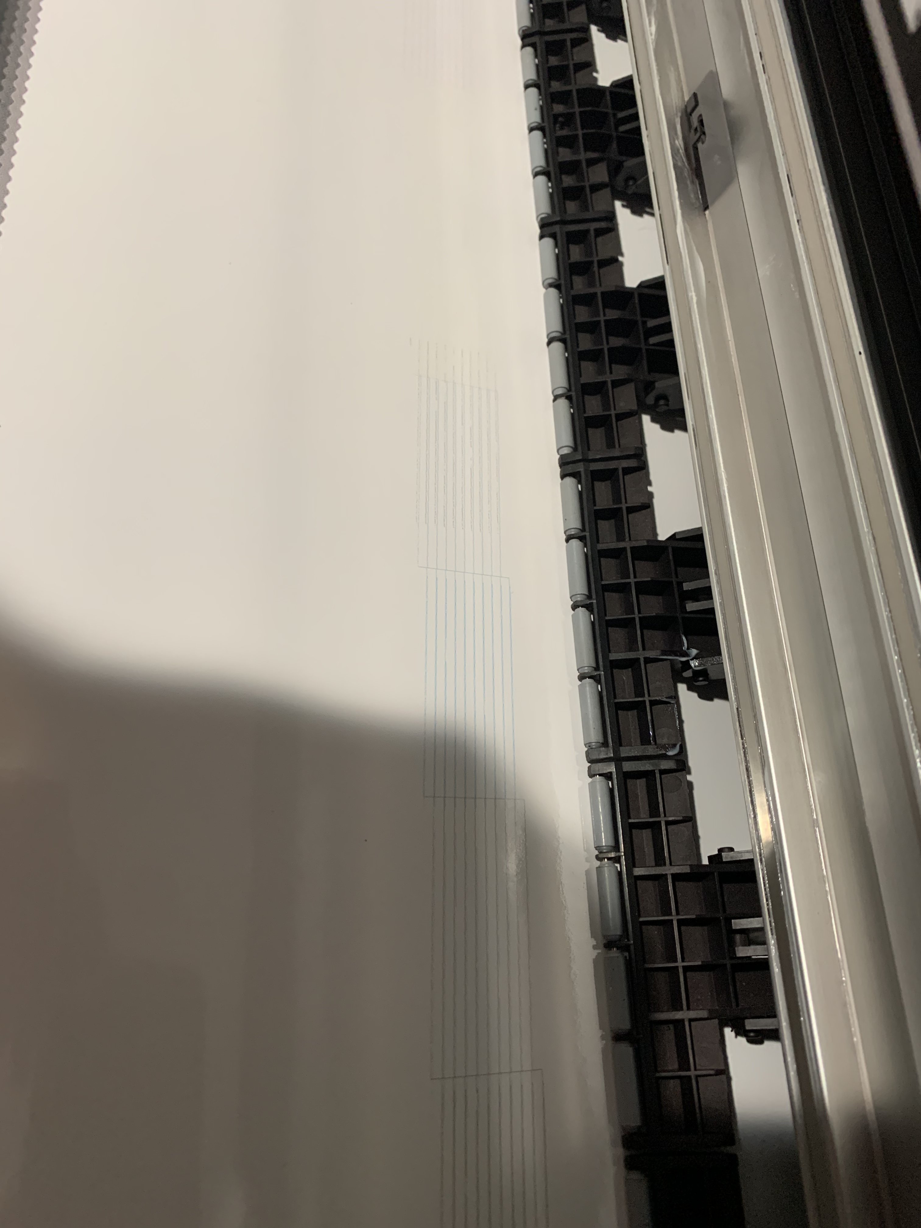

I just did another nozzle check and it is NOT good.
Colors are overlapping
Looks like cyan and black
