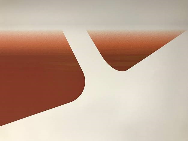

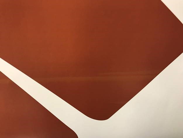

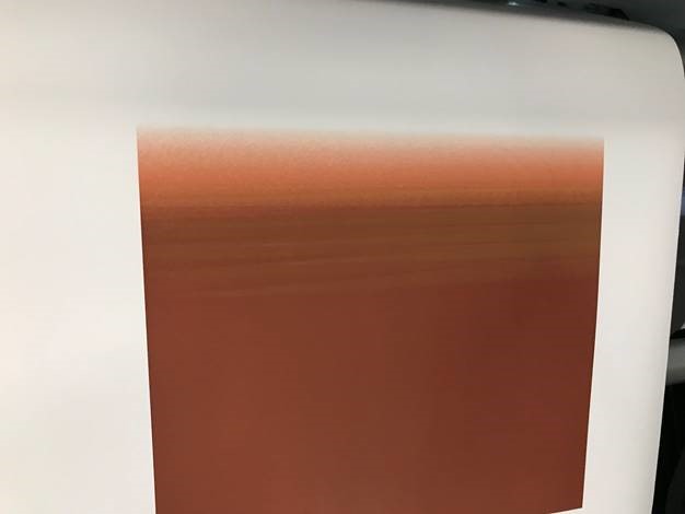

Hi, I'm trying to print a solid color brown on my HP365 Latex printer. I'm printing with the gutters turned on and trying to print on 3M 40C vinyl. I also got the same effect on HP vinyl, so I know it's not a profile issue. I've checked the printhead nozzle outage and they're all working fine, I cleaned the printheads after just to be sure, and I've run the optimizer check and everything seems to be working fine. Anyone have any ideas?

Looks like a color that would use a lot on light magenta and probably light cyan as well. Could be ink starvation. Possibly the lc/lm printhead needs replaced. How many passes? What happens when you slow the printer down like increase inter-pass delay?
Christian @ 2CT Media
I was going to say when printing a lot of solid colors, switch to CMYK only as it prevents the rainbow effect caused by the light colors. That almost looks like condensation build up in the curing tunnel dropping on the media when its moving. Is it random or somewhat repeatable at the same distance apart?
rx7boy
Honestly I had this issue about a year ago when printing a solid blue. Looked like yours ink starvation. I replaced the 2 head and all was good it could print and keep up no problem so I would definitely think it’s a couple of your heads.
HecklnDecalr
I agree, we had the exact same issue and after looking at the head usage we realized that 2 of our heads were past due for a change. Changed them out and it printed perfectly.
Mark295
We get streaks quite a bit when a printhead is going. You need to check the life of each head. Run a printhead diagnostic. This will show you which one is failing. This is an unfortunate aspect of the HP 360s. We always keep on hand one of each printhead and ink
