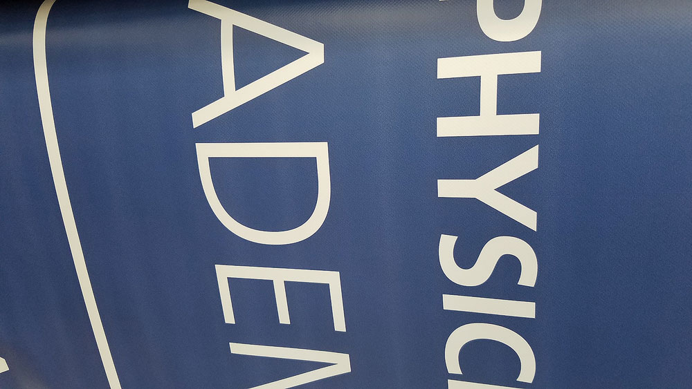

Hello, I am seeing a consistent lighter streak that is supposed to be a solid color. The streaks are vertical so I don't think this is a banding issue.
Printer: HP Latex 260
RIP Program: Caldera 11
Media Type: Seal SolvoPrint Easy Dot
AF
Vacuum, tension and airflow should be lowered for initial testing. Then try drying heat if that doesn’t work.
Andy D
The 1st two responses are probably correct, however, I used to get vertical lines just like that when I had air in my ink lines.
