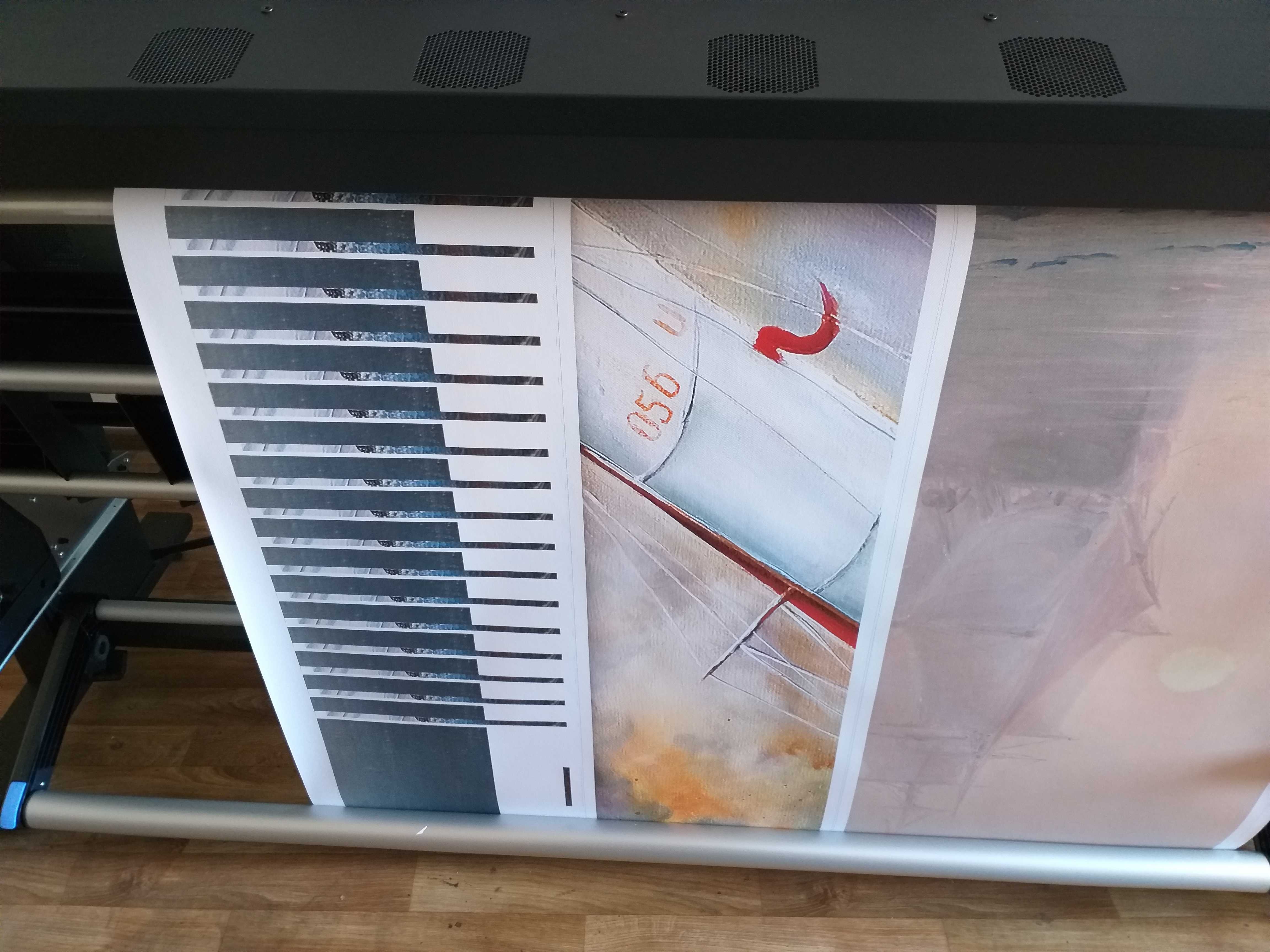

We are using latex 335 HP printer almost about 8 months. This printer comes with Flexi12 RIP included. Usually we print a big nested jobs at once and only from tiff files.
First bad experience we had was after couple of days of usage. We had a buggy output of some files (attachment). Of course first of all we made a request to SAI support with description of problem.
Next we had a long conversation that was based mainly on suggestions that it is something wrong with our hardware, because Flexi uses a lot of companies and none of them had such problems.
After a long trials finally SAI admited that problem is with SW and made a first patch.
Seemd like that patch solved a problem with corrupted tiff files, it was something with proceeding files while ripping namely when files were rotated automatically.
Ok now it seemd like everything fine and you may work and be happy) but no such luck)
Time to time Flexi RIP just crashed for some reasons while printing and as a result - interrupted process and again spoiled materials. It was usual crash that was registered in windows events and it happend because of some unhandeled exception.
Next our conversations about this problem held about 6 months. During this period we heard a lot about our imperfect system, in particular Win 10 pro, about corrupted system user profile, about our patch cord and so on...
Finally SAI found problem on their side (something about when printer lost connection with RIP the last one just crashing :)). by the way printer pluged directly to PC with patch cord and we even changed it for several times to be sure. Also PC has a high HW specifications so chances that it could be connected with HW are low ) and what they do is making another one patch)) ok. They made it, sent to us, we applied. And if in first case problem was solved then in second case crashes became to appear rearely than before but they still remained continuing to increase our financial losses. This fact didnt bother SAI because no one was in hurry to help!
After our explanations to SAI support they just began to pretend that patches should solve all problems and if we still had ones then we just didnt apply patch and we should do it again and if something happend to report)).
To make it clear - during 6 months we had a lot of crashes and all SAI support did is making of useless steps that didnt solve the problem and after each one they asked to report but result was one - wasted materials and another one report to SAI.
Ok bug fixing is time consuming process but when developers skills are low then bug fixing could be endless and as a result it finishes with something like "yes we had a problem, we suggest a solution but if you cant deal with it then it is problem with you not with SW". And this despite the fact that we have good technical background, of course we did all recomendations SAI told, of course SW should properly catch all exceptions or at least developers should make a bug fix to it to catch, of course good developers should make a rebuilt but not patches in order not to argue if patch was applied or not and lot of more, but it is not about SAI.
We spoiled a lot of material with this RIP and nerves. Problem still persists. May be it's related with just RIP, maybe with a bunch of our printer model and Flexi, but all i know is that when you take money for your SW (and it is not cheap) then you should solve this problems ant not in such manner as you do but at a professional skill which you are applying for.
Now we are looking for some new RIP and for sure won't reverse to Flexi.
upd.: in conversation they told that in v19 all bugs fixed (but no fact that it is). To which i answered that why don't they send me v19. And the reply was perfect - your licence is for v12, so it won't work!!!))) Do you understand the level of greed?)) No one will offset the costs for us because of their bugs but with all this they unable to provide licence for working (as they say) product, that even could be built for us without extra options if they are so afraid that we will get something more than we should. Shame on that company! Never again!
