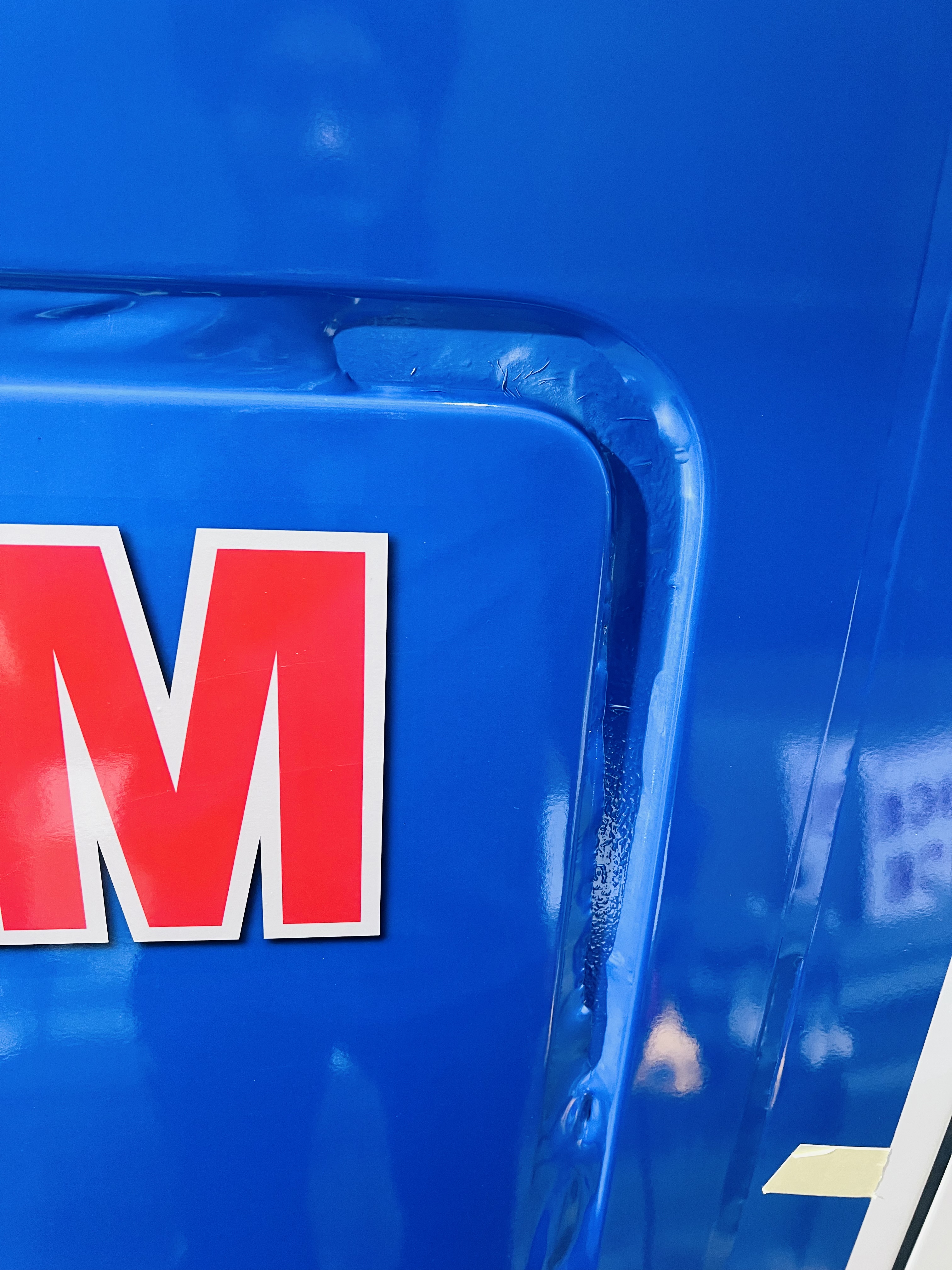

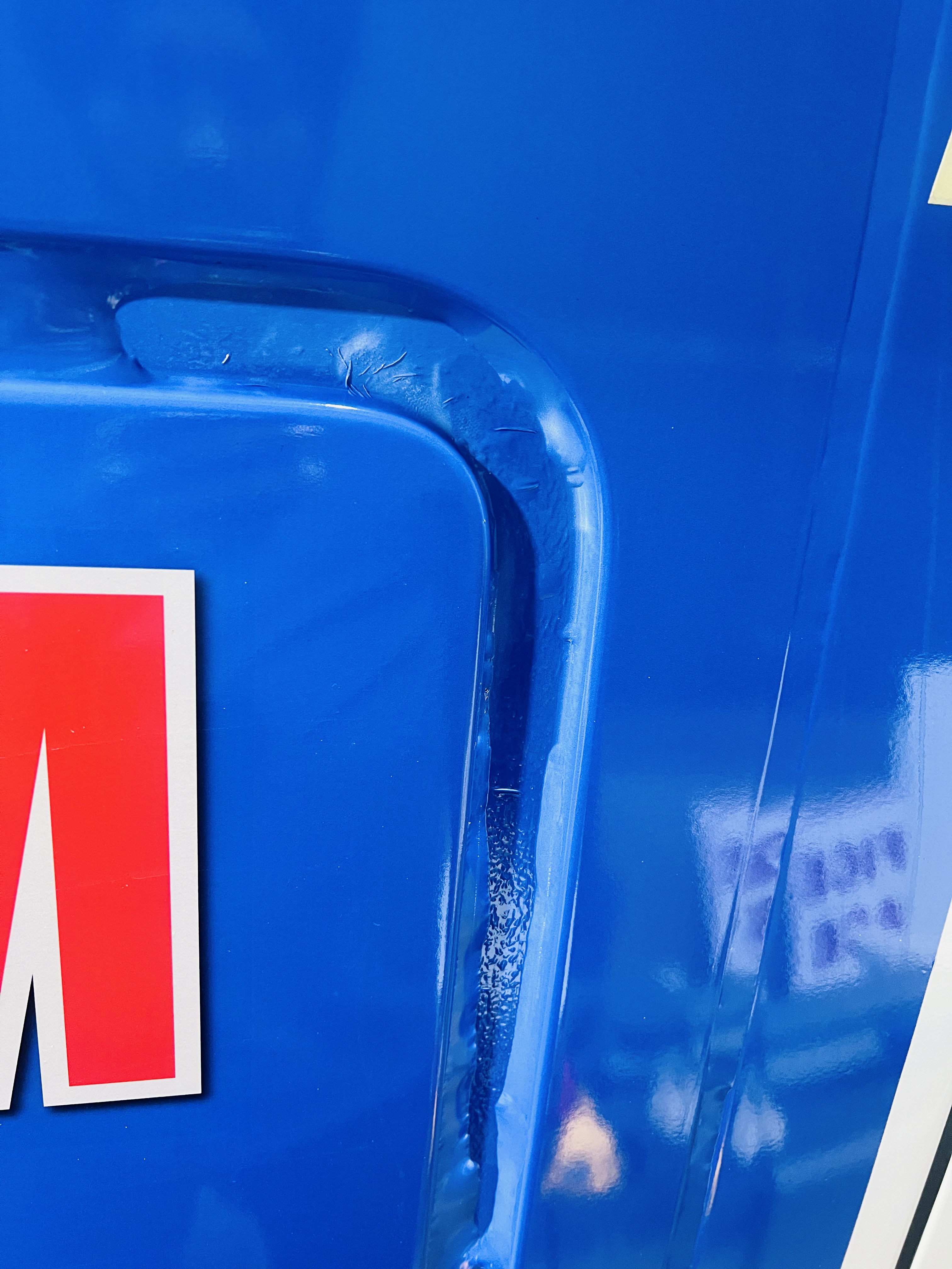

Stuck on this
I am stuck on this even using rolle pro
But can’t stretch anymore

What is this... the window of a panel van?
In any case... you're asking too much of this vinyl. Wrap films aren't designed to be stretched that much, regardless of how much you heat it up (even if you use primer). It's going to lift back up in no time (maybe a few hours or a few days). You need to trim out that window and lay the rest around/underneath it.
MikePro
trim it out. even if you managed to stretch the piss out of the vinyl into that recess, it's going to be discolored and guaranteed to fail as it wants to lift up over time.
Eric H
These probably won't help you now unless you're ripping it off and starting over. Depends what material you used also. I don't have a whole lot of faith with that staying down no matter how it was put on. There's no video on how to cut it that's up to your skill level unless you apply knifeless tape ahead of time there's no easy way to cut it.
