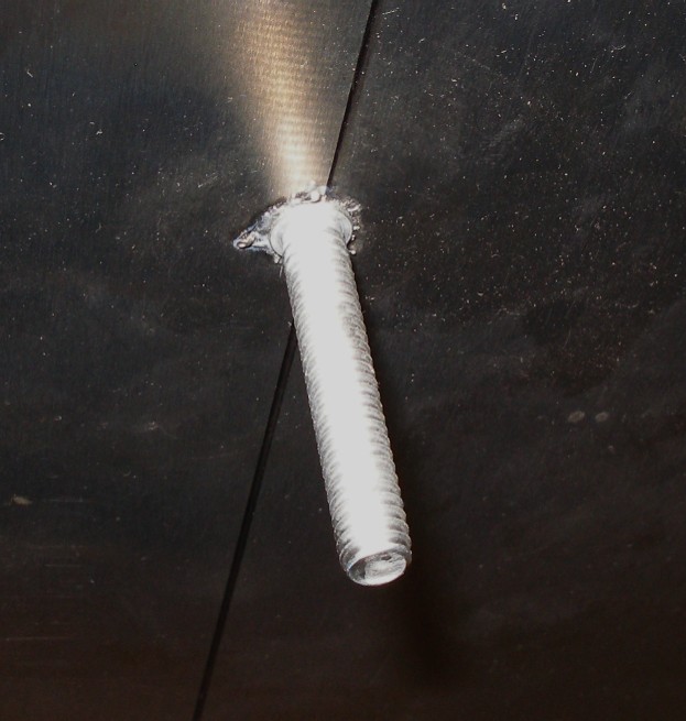

Quick because honestly we've never had to do this before. Customer wants to put studs on the back of aluminum .080 blanks like street signs. How or who should we contact about this...I've contacted several welders and none of them can do this so curious if there is a stud welder itself you use...if the studs are special, etc.
See attached for example

I wonder why welders can't do it...maybe too thin...I've welded onto .063, so that shouldn't be the case...google aluminum stud welder...
chopper
there is a product call panel bond adhesive, it is used in the auto body industry for gluing structural parts of cars, it is a two part epoxy type adhesive but I think it would work great for your application, and it is stronger than welding, and will not cause distortion in the face of your sign, use an elevator bolt and glue them on,
