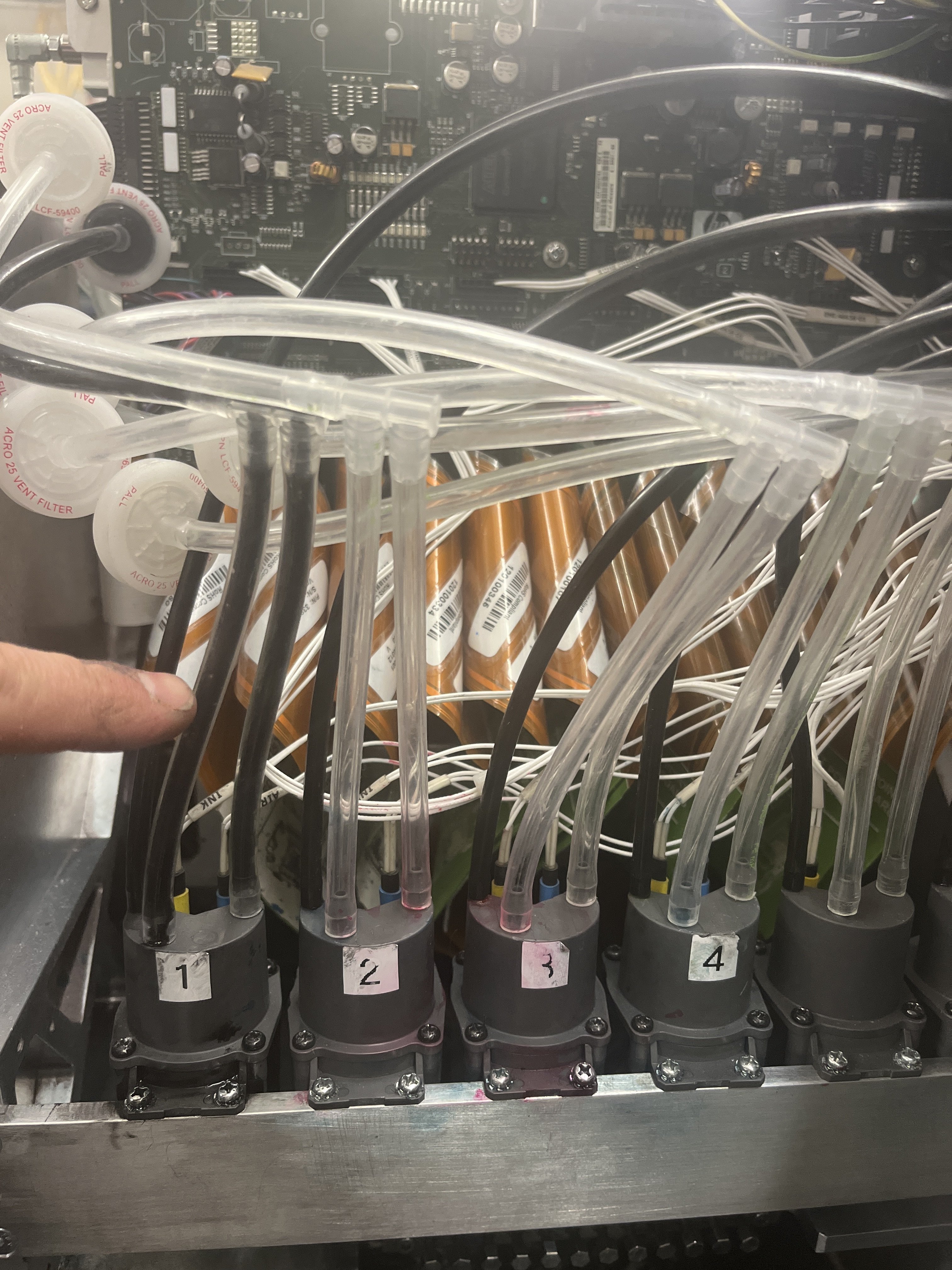

We just came in to find these tubes filled with ink; all the others are filled with air. We never opened this station. Does anyone have any suggestions on how to handle this? So we still have the error with the magenta print head and now we have this error with the black filling the air hoses.

Looks like there’s a vacuum problem, I ran 2 FB700 for 12 years but never encountered this issue
This printer is new to us—we purchased it second-hand and are still in the learning phase. We’ve already spent about 50 hours troubleshooting, and after a lot of effort, we discovered that ink wasn’t flowing through the connection from the ink box to the printer. Once we cleaned that out, the ink began flowing properly.
However, the vacuum cycles with a noticeable sound every 10 seconds. I’m not sure if this is normal, but it doesn’t seem likely. I suspect it’s a vacuum-related issue. Our next step is to determine if this behavior is expected, and if not, to identify and fix any leaks or issues causing the repeated vacuum cycling. The cycling is very consistent, occurring roughly every 10 seconds without variation.
We’ve managed to get the printer to print, but resolving this cycling issue is now our top priority.
Thank you again for your reply—it’s greatly appreciated!
FrankW
There is one Vacuum pump for all ink channels. If you have a problem with one color, it don´t seem to be a vacuum problem. It´s a longer time ago that I serviced this printers, but the vacuum can be adjusted by a little adjustment screw which can be found on the back housing near the power connector of the vacuum pump, and the correct value is shown on the display. It is a longer time ago that I serviced that printers, I do not know exactly where in the menu is the value. I hope you have a service manual.
A short "brmmmm" every 10 seconds seems not strange to me, but I do not remember exactly too.
The printer is really outdated (while it has some amazing features, for example the camera system), and parts cost a lot of money. Its surely nice to work on it and bring it back to live, but this machines can be a real money pit. I wish you luck.
