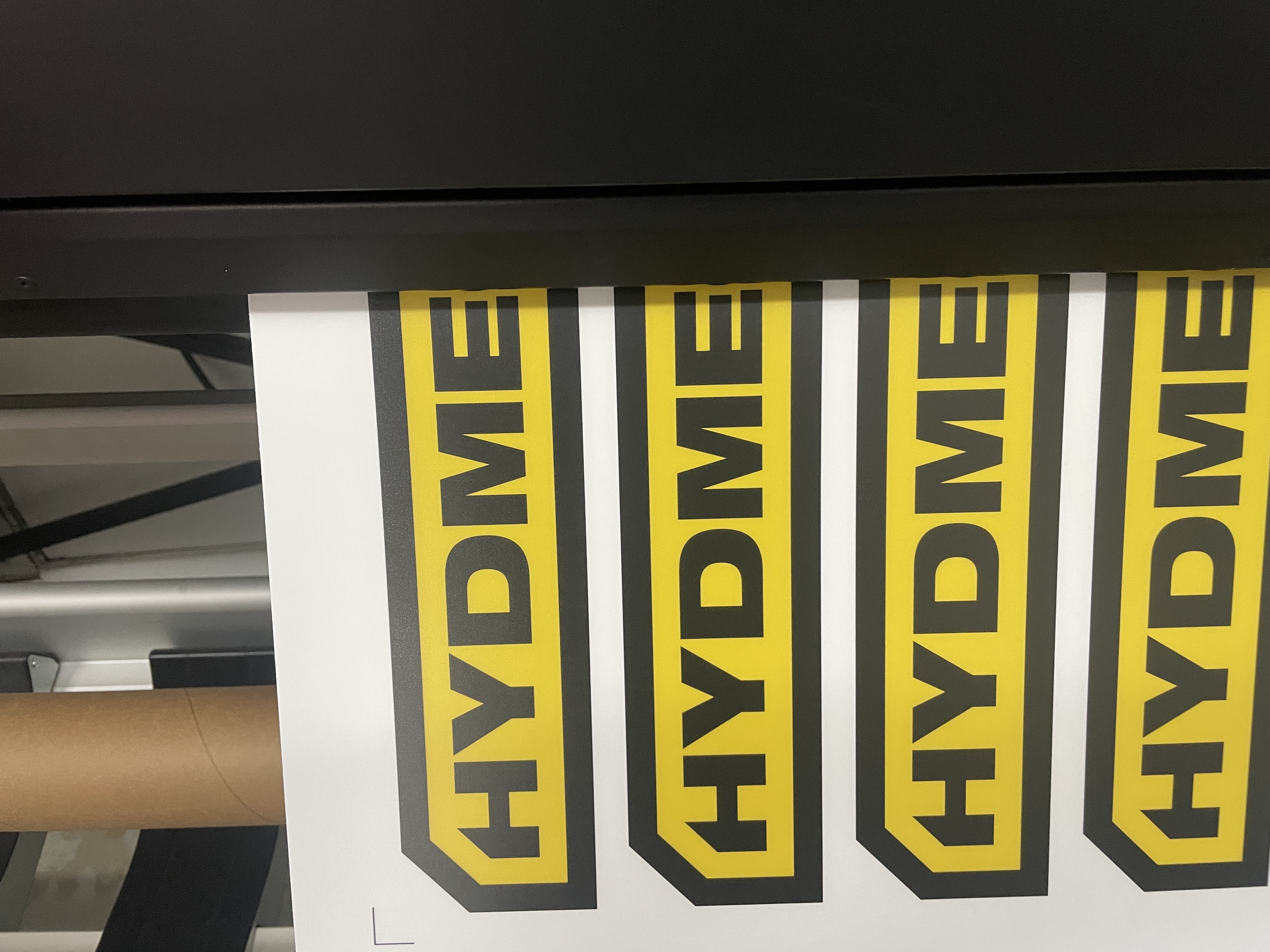

I haven't used much of this stuff, so I'm hoping others have. Previously I printed on a 60" roll of Icon pm-3755 (just a note, I hate their naming conventions, and their website makes my head hurt) with no issues. I have a customer who was wanting industrial labels, with thick laminate, for sticking to powder coat, minimal prep & install. So I bought some ultracurve x2 and icon 440lse to see how they would work for this customer, both in 30" rolls.
I have not had great success getting a uniform ink on them across the width of the roll. I swapped out printheads, dropped from 20passes to 10p to 6p, increased interpass delay, precleaned the area with alcohol, and I've basically always had the same result on the left hand side of the roll. At this point I'm thinking it may just be that this roll was converted from a larger roll, and therefore the cut edge has debris or something interfering with the ink, or the hp 560 doesn't like to heat the whole chamber, and I have a weak cure temp on that side.
Here's a picture, the black on the left two prints is far grainier than the rest, I promise...

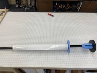

Do you have a takeup unit? Don't know if this would work, but could you steal a core holder from the takeup and test your uneven temp theory?
Maybe you could shift the material to the other side to see if it helped?
Not exactly like this, but you get the idea...
I see what your saying, unfortunately I have 'spindless' takeup, so it just sandwiches either end of the cores. I think the only way to prove this theory is getting a larger roll, or unwinding/rewinding this roll backwards, though I'll mess with other profiles first.

Signarama Jockey
Have you considered static electricity? The "graininess" in your picture looks kind of organic. If it was a printhead problem, it would be regular, right?
I'm guessing that no matter how you rotate the file, that that section of the media always seems to be weird?
Any chance there could be some static buildup on the media? Or that the process of unrolling it is causing some static?

Matt at Substance reached out, sent me some test rolls, and helped me select a better and cheaper product for my application. Additionally, I found that all of my sample printing in the original post was being done on a roll of laminate that I'd confused for print media. It boiled down to mistaking Ultracurve 1000 (overlaminate) and Ultracurve X2 (print media), and since I never got a print I wanted to laminate or plot, I just kept it on the take up reel and kept trying different settings.
The recommended products for my application were 444LSE paired with TL-6100 laminate, and the customer loved the ease of application (thickness and air egress), finish (both from the semi gloss nature of the textured laminate and the rigidity that kept the 'orange peel' type finish on the powder coat from showing through), and aggressive adhesive.
