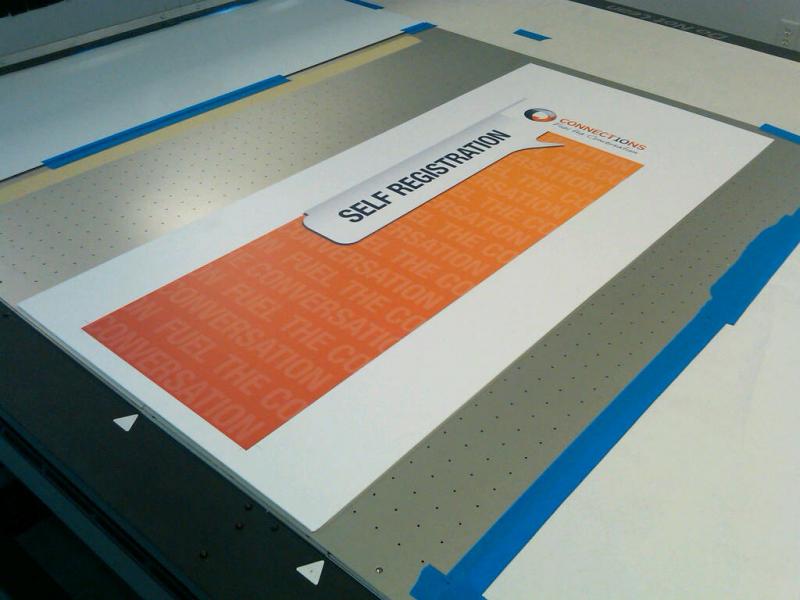

Sucess! After a ton of trial and error we were able to dial the machine in just right and print on 1/8" PVC. In the end, it was a specific combination of color profile, dot gain, print speed, head height, and UV level - but it works beautifully!
Now to get to work printing the paying jobs!

sorry, the rastek i have has shutters that will open and close with each pass. you can configure which lamps open and close with each pass direction. the lamps are on all of the time. hope i didnt confuse you and im glad you got it working. i had a alot of trial and error with the flatbed and its still an ongoing process. thanks you posting your solution. good luck!!!
