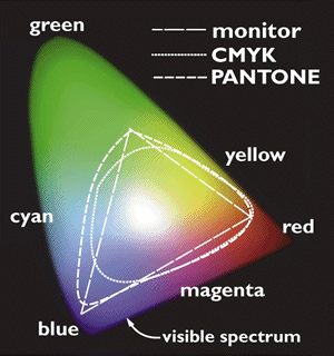

That's because you don't have a properly calibrated and profiled system. RGB will not not expand the gamut to a CMYK device.
The RBG vs CMYK Colour Specturm below shows why
your still wrong.
if you look the monitor color covers more area than cmyk color. so if you use the cmyk color space (us swop?) then any colors your printer may be able to print outside that cmyk are not available to you. and then if you use adobe rgb1998 the colors available are even greater..
i'm not saying you will get all those colors but you will get as close as possible with your printer.
of course your profiles and settings (rendering intents) will effect the outcome but rgb gives you a larger printing gamut. cmyk seems to be more predictable in some cases but rgb will help you get all you cam from the printer.
when i design (in adobe) i use adobe rgb1998 .. if i use cmyk swop it limits the colors to the cmyk swop colors and my printer is capable of more colors than the SWOP profile has. i still soft proof to see how much things might change sometimes (bright yellows can look greenish)

your still wrong.
Design to the printer colour space, i.e. use that profile in PhotoShop. Why would you use a SWOP profile when it's intended for Web Offset Printing and has a narrower gamut? Press ink hues and digital ink hues are very different too and will exhibit what you described.
Likewise using adobeRGB will create problems as it has a wider colour gamut and colours will get clipped and you will spend countless time colour correcting.
