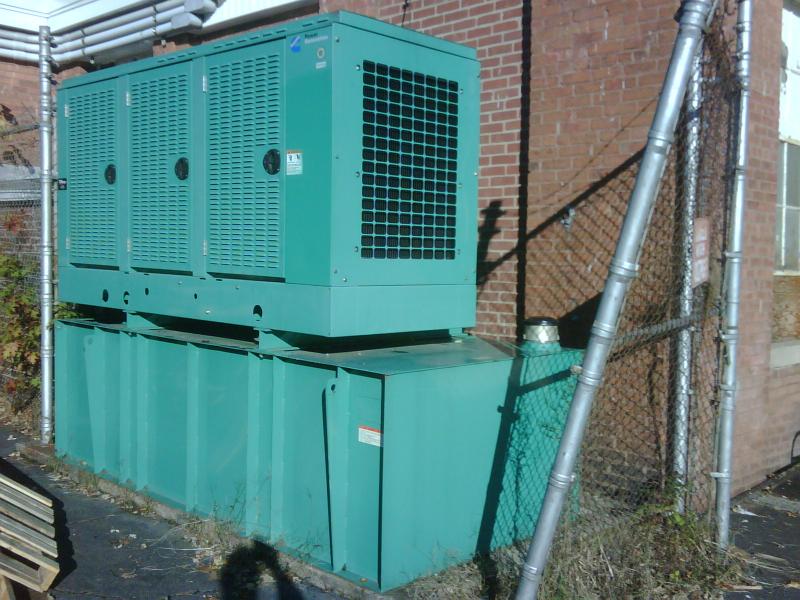

Here is what works for us. 2200 amps of Uninterruptible Power....
