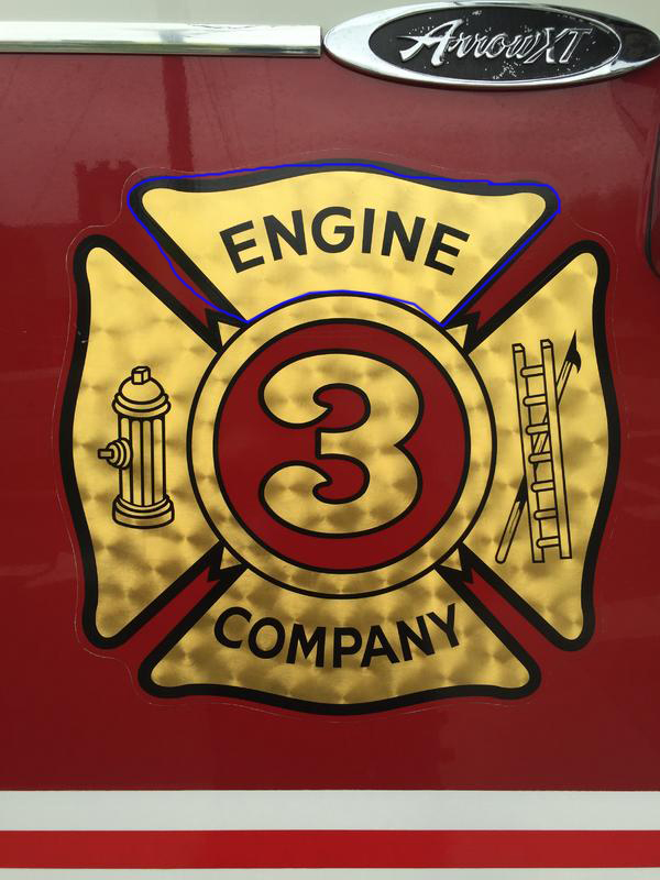

I guess I have just been lucky so far, but I have never had any real gold graphics that I couldn't break down to fit the 11.88" print width of the Edge. Sometimes it is a pain and things have to be broken down in awkward ways, but I have made it work. But now I have to replicate this maltese cross at 14" wide for a different truck. My process for real gold basically involves laying the leaf on one layer of clear and then covering that with a second layer of clear with the areas in the design where the finished gold will be left clear. I use the Edge to print because of the opaque colors that keep the gold from showing through the top layer. So my question is what options do I have to make this work? Is finding someone with a Summa DC my only option? Or do you think a solvent printer can lay down an opaque enough black on clear? Or maybe there is another solution I'm overlooking. I was actually looking at Summa printers a while back, but decided to hold off and eventually get a latex instead. I'm starting to regret that decision now.

I would do a contour cut on the black rather than have all that clear extending past the print area. I'd break the graphic apart where I did show the blue line so I have the top with the outter black border the printed letters and would cut it away where the edge meets the inner circle. the black printed area would be two pieces and butt the top to the bottom with not overlaps needed.
There isn't enough "black" area there to be able to break it up. There has to be a decent sized border around the gold in order to seal it and prevent any delamination issues. But you are right, I don't necessarily have to have all that clear around the edges. I normally keep it around 1/8"-1/4" depending on what I'm doing.
couldn't you just take the top cog of the cross off. Then and run as two separate pieces. You wouldn't see a cut line if it was between the black and gold. Just a little half circle. Then layer with a single piece of clear overtop.

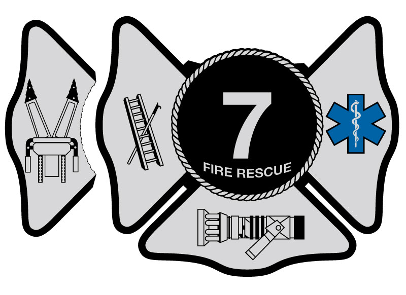

We just did this the other day for a print that HAD to match an existing one (wrecked one door). It works "ok", but in this case I would go with a solvent print on clear overlay.
