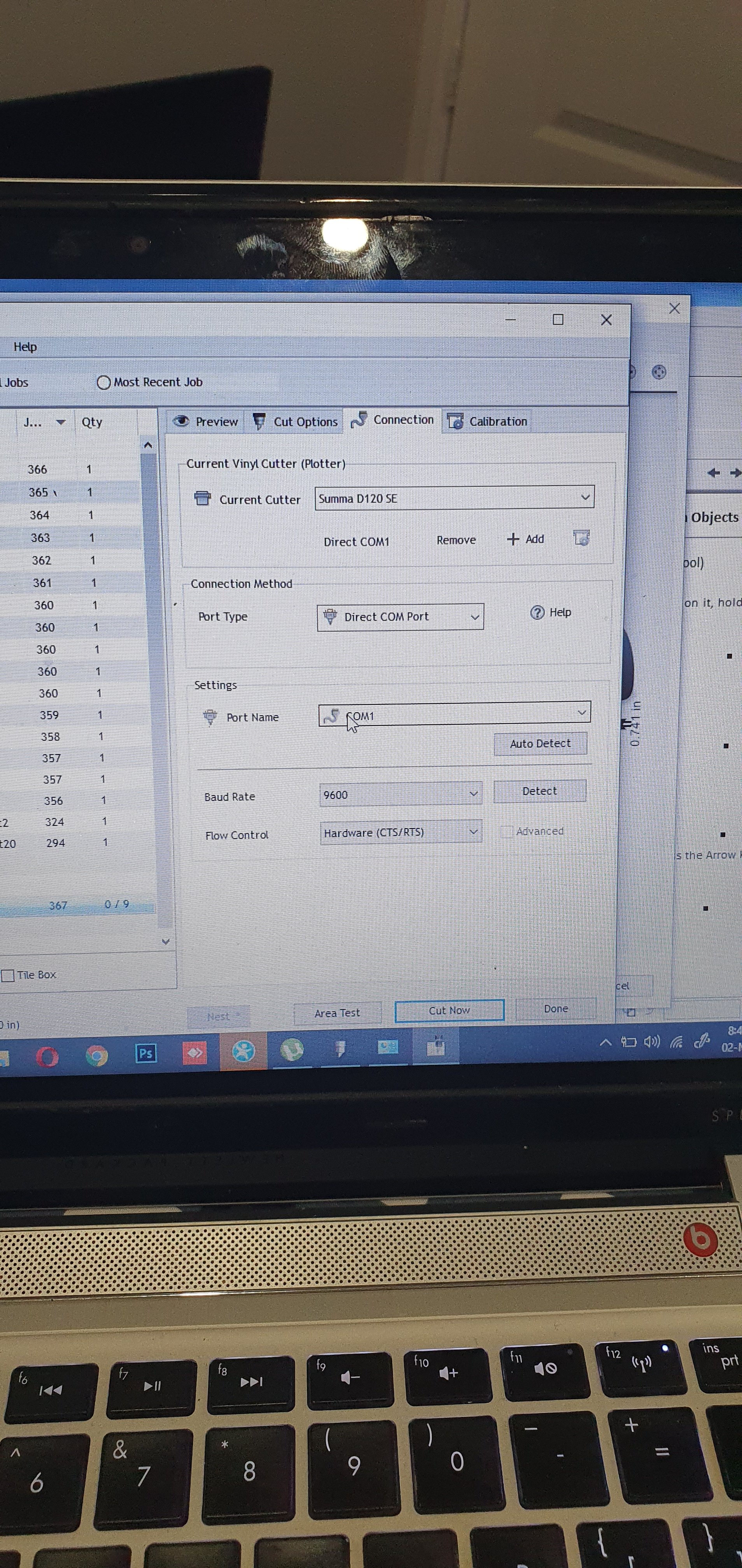

Hello I'm having a little issue connecting my summa d120 see cutter to I can start to cut
Operating system: window 10
Connection type: usb , rs232
Software: summa going
Problem: the cutter is just not popping up..
FrankW
Your cutter is not supported by Gosign. Gosign only supports newer Summacut RL-models, S One and S2.

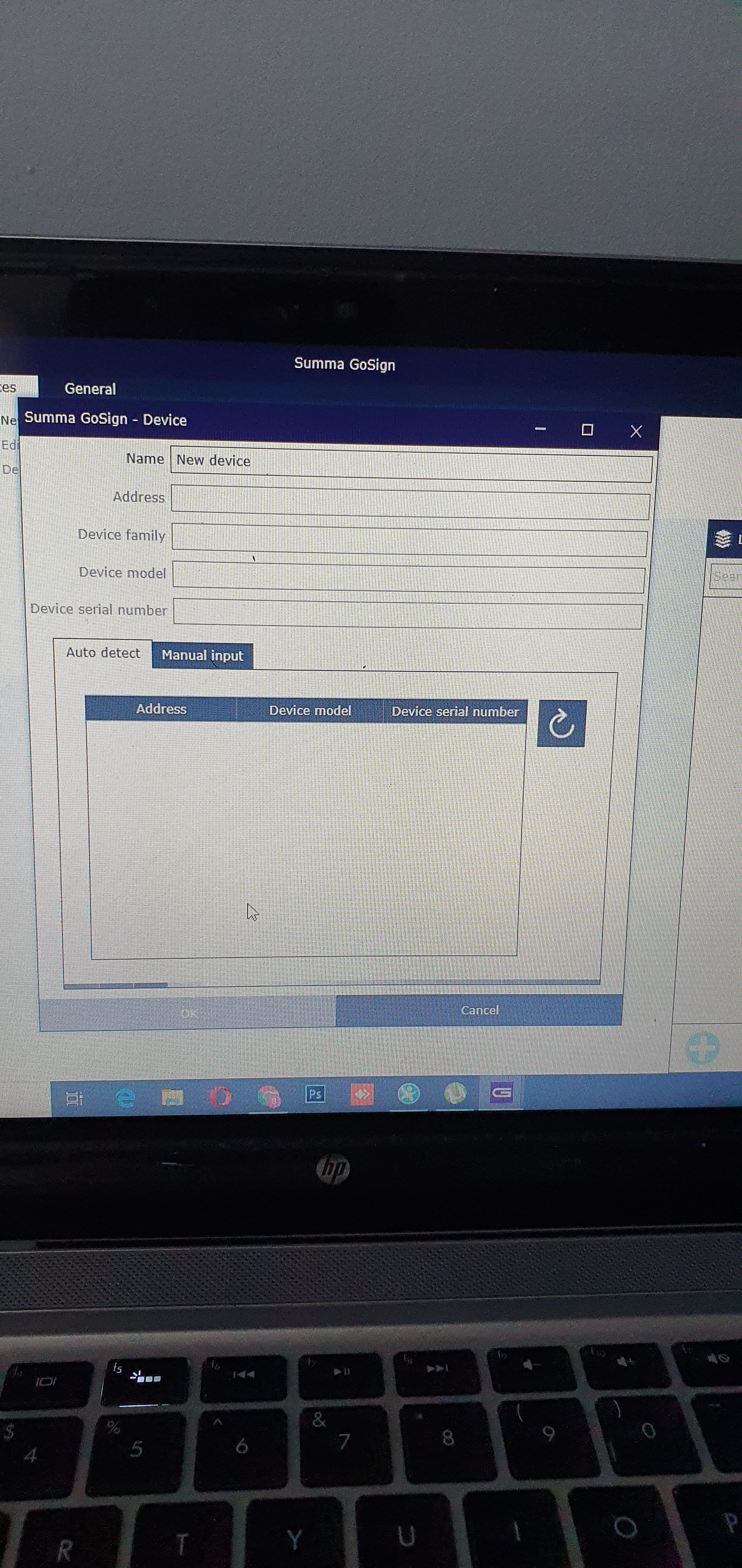

Udesignz
Thanks for your help frank, I had to change a few settings on the cutter (hpgl) then I changed the connection cord to comp (rs232)
Now I'm using vinyl master software to it from it working for now...
